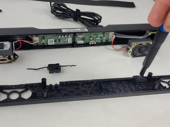

  4. Dell AC511 Hanger Replacement, Hanger: crwdns2935265:04crwdnd2935265:01crwdnd2935265:02crwdne2935265:0 Dell AC511 Hanger Replacement, Hanger: crwdns2935265:04crwdnd2935265:02crwdnd2935265:02crwdne2935265:0
    • The speakers do not have to have been removed for this step, though it may make it easier.
    • Remove the screws from the hangers you are looking to replace using a JIS #1 screwdriver.
    • We accidentally removed some of the rubber lining the inside along with the hanger. Use a razor to cut it off before removing the hanger.
