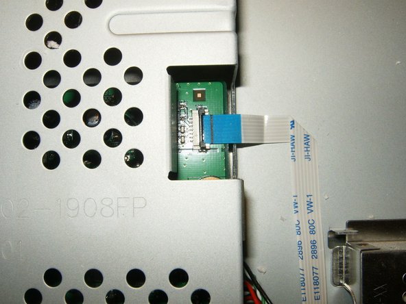

    • Here is the connector for the cable from the front button bar.
    • Unhook the cable by simply flipping the black clip away from the cable side.
    • Removing the cable will allow for the removal of the front bezel
  5. Dell 1908FPb monitor power supply Replacement: crwdns2935265:05crwdnd2935265:01crwdnd2935265:03crwdne2935265:0 Dell 1908FPb monitor power supply Replacement: crwdns2935265:05crwdnd2935265:02crwdnd2935265:03crwdne2935265:0 Dell 1908FPb monitor power supply Replacement: crwdns2935265:05crwdnd2935265:03crwdnd2935265:03crwdne2935265:0

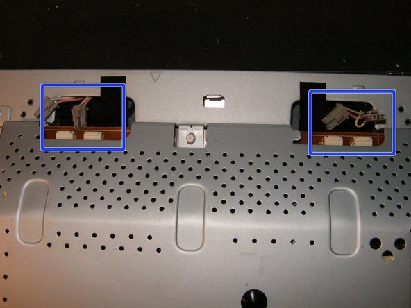

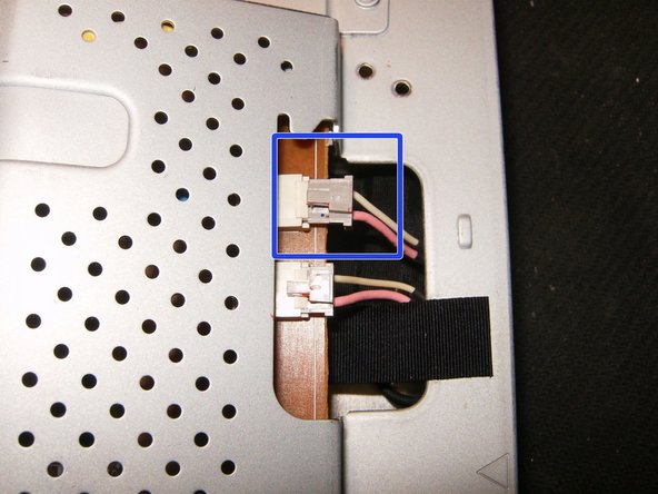

    • Next is the cover for the CCFL cables.
    • Lift the middle security tab,
    • and slide the cover into the opposite direction of the imprinted arrow
    • the cover can now be removed. Clearly visible are the connectors from the inverter to the CCFL's. This monitor uses four (4) tubes.
  7. Dell 1908FPb monitor power supply Replacement: crwdns2935265:07crwdnd2935265:01crwdnd2935265:03crwdne2935265:0 Dell 1908FPb monitor power supply Replacement: crwdns2935265:07crwdnd2935265:02crwdnd2935265:03crwdne2935265:0 Dell 1908FPb monitor power supply Replacement: crwdns2935265:07crwdnd2935265:03crwdnd2935265:03crwdne2935265:0
    • Use a screwdriver (or your fingernails) to lift the security tab
    • and remove the wire from the connector.
    • Remove all four (4) connectors

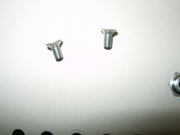

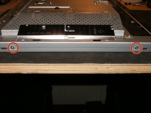

    • Remove the two Phillips screws on the right side of the panel.
    • The screws are M2x5
    • Remove the two Phillips screws on the left side of the panel. They are identical to the right side.

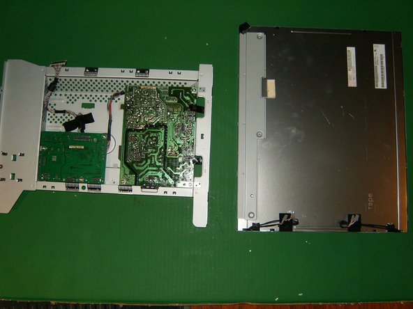

  9. Dell 1908FPb monitor power supply Replacement: crwdns2935265:09crwdnd2935265:01crwdnd2935265:03crwdne2935265:0 Dell 1908FPb monitor power supply Replacement: crwdns2935265:09crwdnd2935265:02crwdnd2935265:03crwdne2935265:0 Dell 1908FPb monitor power supply Replacement: crwdns2935265:09crwdnd2935265:03crwdnd2935265:03crwdne2935265:0

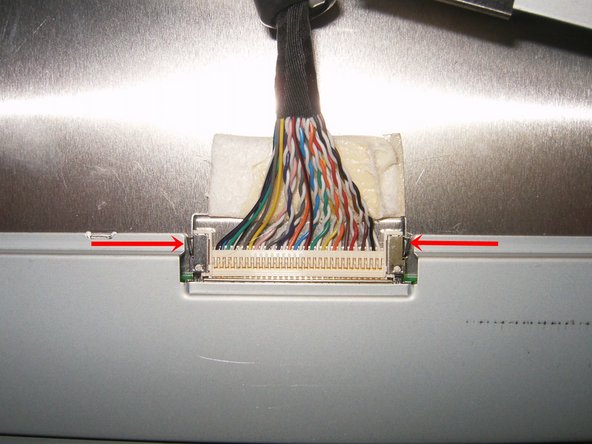

    • Do not remove the metal case from the panel yet. Slide it upward in the direction of the arrow, this will make the display data connector more accessible
    • To remove the connector, squeeze both metal clips together. Remove the cable by gently pulling on the connector, not the cable.

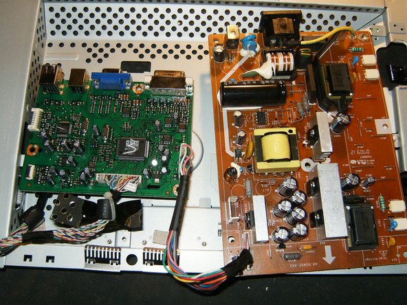

    • The panel and the metal case can now be separated. The power supply and the video board are both contained on the inside of the metal case.

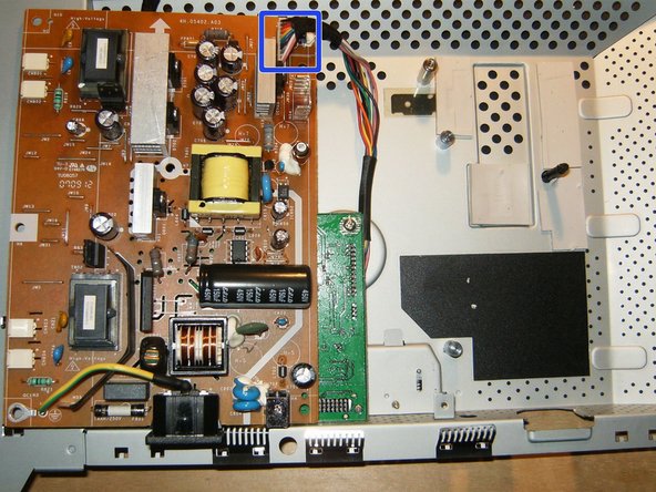

  10. Dell 1908FPb monitor power supply Replacement: crwdns2935265:010crwdnd2935265:01crwdnd2935265:03crwdne2935265:0 Dell 1908FPb monitor power supply Replacement: crwdns2935265:010crwdnd2935265:02crwdnd2935265:03crwdne2935265:0 Dell 1908FPb monitor power supply Replacement: crwdns2935265:010crwdnd2935265:03crwdnd2935265:03crwdne2935265:0

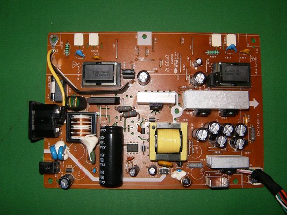

    • This is the power supply,
    • and the video board.

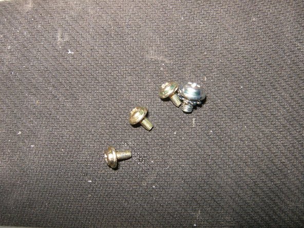

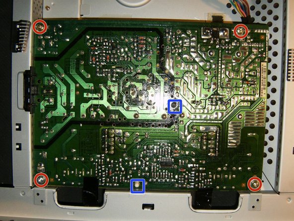

    • The power supply is mounted with four Phillips screws and two plastic standoffs
    • Remove the four screws. Three of those are brass colored M3x5, the bottom left is nickel colored M4x5 and is the grounding screw.

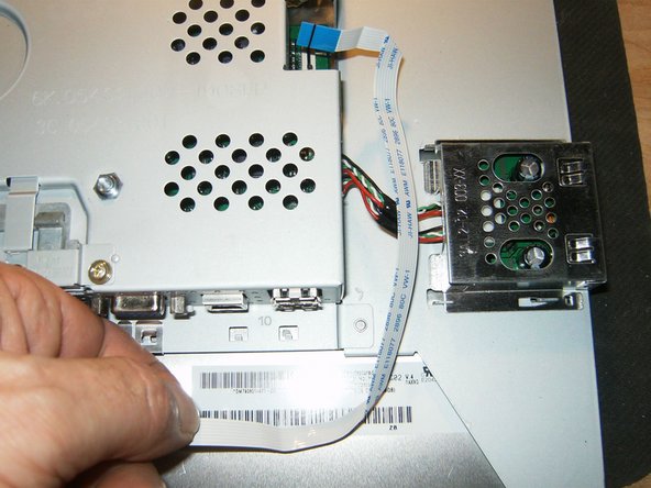

  11. Dell 1908FPb monitor power supply Replacement: crwdns2935265:011crwdnd2935265:01crwdnd2935265:03crwdne2935265:0 Dell 1908FPb monitor power supply Replacement: crwdns2935265:011crwdnd2935265:02crwdnd2935265:03crwdne2935265:0 Dell 1908FPb monitor power supply Replacement: crwdns2935265:011crwdnd2935265:03crwdnd2935265:03crwdne2935265:0
    • To loosen the plastic standoffs, use a pair of needle nose pliers (or similar) and squeeze the tops to free the board. Once it is free, flip it over onto the video board.
    • The cable from the power supply to the video board does not come off easy. To ensure that the connector will not break, it may be necessary to remove it from the video board. For that, remove the video board.

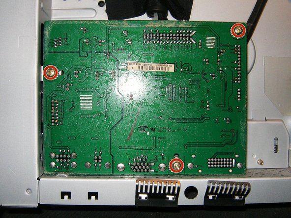

    • Remove the three Phillips screws. They are M3x5

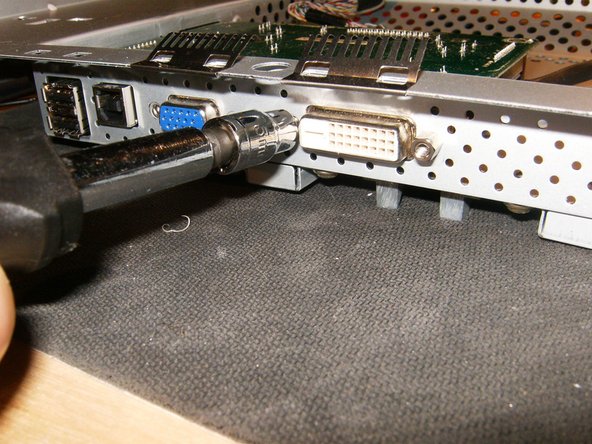

  12. Dell 1908FPb monitor power supply Replacement: crwdns2935265:012crwdnd2935265:01crwdnd2935265:03crwdne2935265:0 Dell 1908FPb monitor power supply Replacement: crwdns2935265:012crwdnd2935265:02crwdnd2935265:03crwdne2935265:0 Dell 1908FPb monitor power supply Replacement: crwdns2935265:012crwdnd2935265:03crwdnd2935265:03crwdne2935265:0
    • Remove the four standoff screws. Two from the VGA connector and two from the DVI connector.
    • Use a pair of pliers or a 4mm socket to remove the standoffs.
    • Remove the video board from the metal casing. There will be easy access to the cable with the power supply and the video board turned over.
  13. Dell 1908FPb monitor power supply Replacement: crwdns2935265:013crwdnd2935265:01crwdnd2935265:02crwdne2935265:0 Dell 1908FPb monitor power supply Replacement: crwdns2935265:013crwdnd2935265:02crwdnd2935265:02crwdne2935265:0
    • Disconnect the power supply connector from the video board.
    • The power supply can now either be replaced or repaired.
