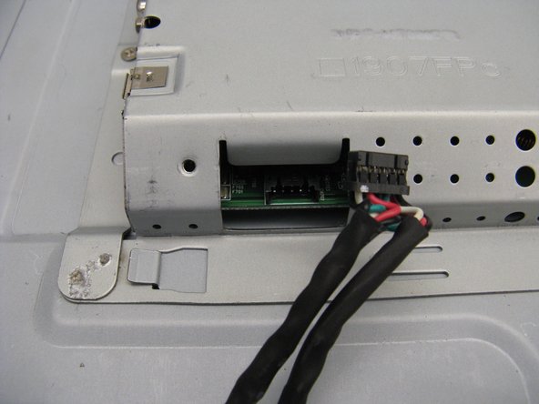

    • Locate the USB port cover on the right hand side of the monitor.
    • Remove the one 5 mm Phillips #2 screw.
    • Remove the USB port cover by sliding it out and away from the monitor.
  6. Dell 1907FPc Monitor Power Supply Replacement: crwdns2935265:06crwdnd2935265:01crwdnd2935265:02crwdne2935265:0 Dell 1907FPc Monitor Power Supply Replacement: crwdns2935265:06crwdnd2935265:02crwdnd2935265:02crwdne2935265:0
    • Disconnect the USB ports by gentling grasping and pulling on the connector.

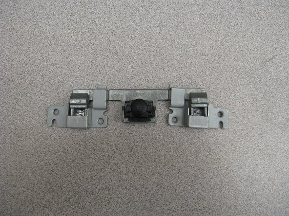

  8. Dell 1907FPc Monitor Power Supply Replacement: crwdns2935265:08crwdnd2935265:01crwdnd2935265:02crwdne2935265:0 Dell 1907FPc Monitor Power Supply Replacement: crwdns2935265:08crwdnd2935265:02crwdnd2935265:02crwdne2935265:0
    • Remove the four 4 mm Phillips #2 screws that secure the monitor mount release mechanism to the panel.
    • Set this mechanism off to the side, taking care to keep it all in one piece.

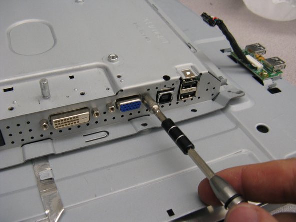

  9. Dell 1907FPc Monitor Power Supply Replacement: crwdns2935265:09crwdnd2935265:01crwdnd2935265:02crwdne2935265:0 Dell 1907FPc Monitor Power Supply Replacement: crwdns2935265:09crwdnd2935265:02crwdnd2935265:02crwdne2935265:0
    • Use a 5 mm nut driver to remove the four 12 mm standoff screws securing the video connectors to the panel.

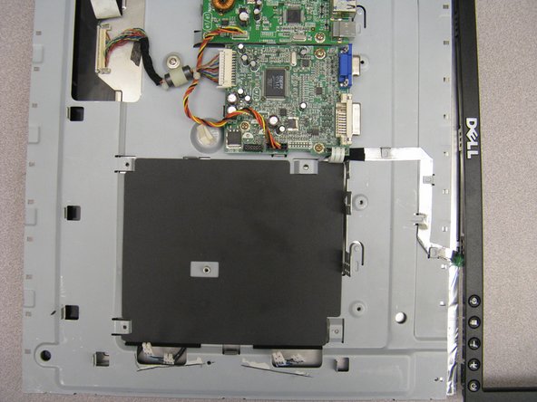

  12. Dell 1907FPc Monitor Power Supply Replacement: crwdns2935265:012crwdnd2935265:01crwdnd2935265:02crwdne2935265:0 Dell 1907FPc Monitor Power Supply Replacement: crwdns2935265:012crwdnd2935265:02crwdnd2935265:02crwdne2935265:0
    • The power supply has several large capacitors (they look like little cylinders), that can shock you if they discharge. Be careful not to touch them as you continue to work.
    • Use the tweezers to remove the four connectors from the power supply board.
  13. Dell 1907FPc Monitor Power Supply Replacement: crwdns2935265:013crwdnd2935265:01crwdnd2935265:01crwdne2935265:0
    • Remove the five 7 mm Phillips #2 screws from the power supply board.
  14. Dell 1907FPc Monitor Power Supply Replacement: crwdns2935265:014crwdnd2935265:01crwdnd2935265:02crwdne2935265:0 Dell 1907FPc Monitor Power Supply Replacement: crwdns2935265:014crwdnd2935265:02crwdnd2935265:02crwdne2935265:0
    • Open up the clip securing the wires running between the power supply and video boards.
    • Gently remove the connector running from the video board to the power supply board.
  15. Dell 1907FPc Monitor Power Supply Replacement: crwdns2935265:015crwdnd2935265:01crwdnd2935265:02crwdne2935265:0 Dell 1907FPc Monitor Power Supply Replacement: crwdns2935265:015crwdnd2935265:02crwdnd2935265:02crwdne2935265:0
    • The power supply board can now be removed.
