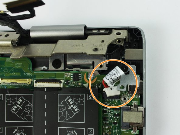

  5. Dell   Inspiron  15-7569 Motherboard Replacement: crwdns2935265:05crwdnd2935265:01crwdnd2935265:02crwdne2935265:0 Dell   Inspiron  15-7569 Motherboard Replacement: crwdns2935265:05crwdnd2935265:02crwdnd2935265:02crwdne2935265:0
    • (Continued)Unplug all wires from motherboard, including battery wire, speaker wire, screen wire, and other component wires
    • Remove the black battery cable.
    • Remove the blue ribbon cable.
    • Unscrew and remove hard drive/SSD.
    • Disconnect the hard drive/SSD from the motherboard.
  6. Dell   Inspiron  15-7569 Motherboard Replacement: crwdns2935265:06crwdnd2935265:01crwdnd2935265:02crwdne2935265:0 Dell   Inspiron  15-7569 Motherboard Replacement: crwdns2935265:06crwdnd2935265:02crwdnd2935265:02crwdne2935265:0
    • Gently remove the motherboard from the device.
