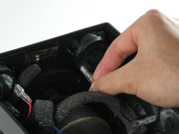

  5. Definitive Technology W7 Tweeters Replacement, Tweeters: crwdns2935265:05crwdnd2935265:01crwdnd2935265:02crwdne2935265:0 Definitive Technology W7 Tweeters Replacement, Tweeters: crwdns2935265:05crwdnd2935265:02crwdnd2935265:02crwdne2935265:0
    • Pull gently on the two red wires to disconnect them individually from the tweeter.
  6. Definitive Technology W7 Tweeters Replacement: crwdns2935265:06crwdnd2935265:01crwdnd2935265:01crwdne2935265:0
    • Use the Phillips #0 screwdriver to remove the three black screws attaching the tweeter to the housing.
  7. Definitive Technology W7 Tweeters Replacement: crwdns2935265:07crwdnd2935265:01crwdnd2935265:01crwdne2935265:0
    • Gently press down, from the outside of the case, on the tweeter to free it from the speaker case.
    • Ensure that you have an additional hand underneath the tweeter to catch it when it falls from the speaker case.
    • Repeat Steps 1-3 for the other tweeter if necessary.
