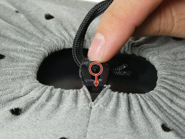

    • After you remove the black panel, you will see that the device is covered with a gray mesh, secured with a drawstring.
    • Flick the switch on the middle of the lock down to loosen the sack.
  5. Definitive Technology W7 Speaker Replacement: crwdns2935265:05crwdnd2935265:01crwdnd2935265:01crwdne2935265:0
    • After you have flicked the switch loosen the sack and pull the sack down which will reveal the speaker.

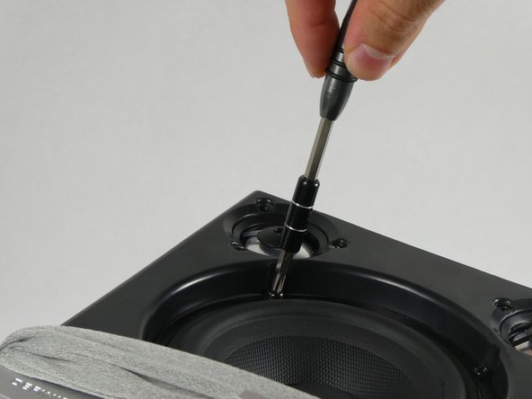

  9. Definitive Technology W7 Speaker Replacement: crwdns2935265:09crwdnd2935265:01crwdnd2935265:02crwdne2935265:0 Definitive Technology W7 Speaker Replacement: crwdns2935265:09crwdnd2935265:02crwdnd2935265:02crwdne2935265:0
    • Remove the four Phillips #0 screws around the speaker holding it in place.
    • Now lay the device on its side with the speaker facing upward, then unscrew the screws around the speaker.
