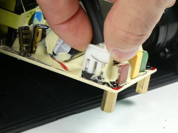

  5. Definitive Technology W7 Power Supply Replacement, Power Supply: crwdns2935265:05crwdnd2935265:01crwdnd2935265:01crwdne2935265:0
    • Use a Phillips #2 screwdriver to remove the four 5 mm black screws on the side of the device.
  6. Definitive Technology W7 Power Supply Replacement: crwdns2935265:06crwdnd2935265:01crwdnd2935265:03crwdne2935265:0 Definitive Technology W7 Power Supply Replacement: crwdns2935265:06crwdnd2935265:02crwdnd2935265:03crwdne2935265:0 Definitive Technology W7 Power Supply Replacement: crwdns2935265:06crwdnd2935265:03crwdnd2935265:03crwdne2935265:0
    • Unclip the two white connectors from the power supply. This is done by pressing the two white plastic strips on the clip together, then, pulling upwards.
    • If removing the clips from the power supply is difficult by hand, use pliers to press the two white plastic strips together, then pull upwards.

I was wondering if you have the part number or a source for the power supply board. I took it out hoping to find a part number but no luck. Thank you in advance for your help.
Bill - crwdns2934203:0crwdne2934203:0
I also have had no luck finding a new original psu after it failed. But it is a 24v psu, and it has a 3amp diode on the output, so it has a theoretical max output of 72watt. So i whent with a MW RPS-120-24 as a replacement, it has a max output of 84w without a fan. The output connector is not the same, so it needs to be modifyed.
FK87 -
This statement in the Introduction is incorrect, possibly dangerously so. The power supply board includes several large filtering capacitors. These can retain high voltages for minutes or longer, even after the device is unplugged. Accidentally shorting certain pins on the board while performing step 6 above can result in arcing or shock.
Frank Osani - crwdns2934203:0crwdne2934203:0
Nice write up, I discovered same thing today when I wanted to troubleshoot my W7. Supply is dead and upon closer inspection, I believe it is plain poor QA, PERIOD. Most of the components are cold soldered and when I attempted to repair those connections, the solder pads immediately lifted. Want to add that in my younger days, was an engineer and designed machines and PCBA's so aware of how to solder. I decided it is a lost cause and just ordered a 24VDC supply from Amazon that I will hack into or onto this cube. Gaining some headway, prompted me to look into my w9 studio, also dead. After digging through the assembly, got the PS board along with Wi-Fi and amp. Power supply has been reworked by someone that had no clue what they were doing. Kinda SUCKS, cause I both this new and it dies just a hair over 1 year and Definitive basically said go pound sand. SO two expensive devices died within a short period of time. Will dig more into the W9, 24VDC supplies are active but the 5VDC aren't. They made it impossible to replace any components tough.
John Blazek - crwdns2934203:0crwdne2934203:0
How do you make modification to MW RPS-120-24 4 PIN connector?
