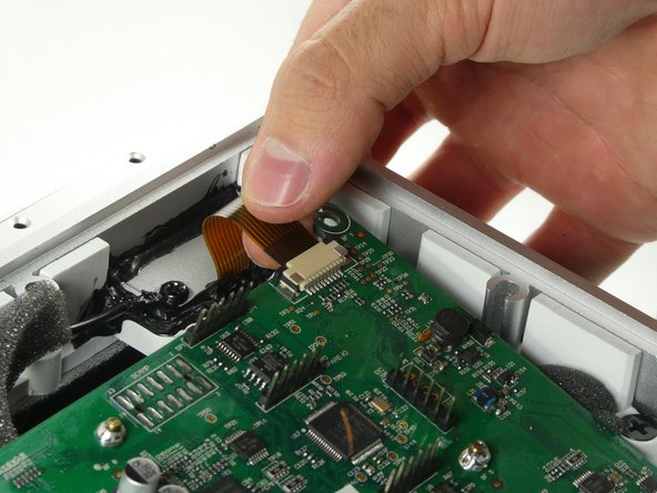

    • Push up the locking tabs on the sides of the ribbon cable connector.
    • Gently pull the ribbon cable out from the connector to remove it.
  4. Definitive Technology W7 Motherboard Replacement: crwdns2935265:04crwdnd2935265:01crwdnd2935265:02crwdne2935265:0 Definitive Technology W7 Motherboard Replacement: crwdns2935265:04crwdnd2935265:02crwdnd2935265:02crwdne2935265:0

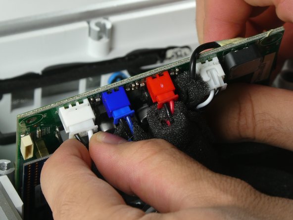

    • Tilt the motherboard outwards from the speaker.
    • Remove all five connectors from the motherboard.
    • Remove the motherboard from the speaker.

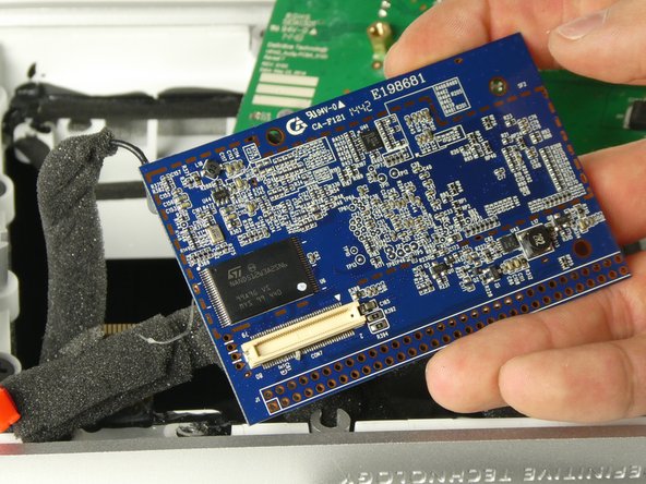

  5. Definitive Technology W7 Motherboard Replacement: crwdns2935265:05crwdnd2935265:01crwdnd2935265:02crwdne2935265:0 Definitive Technology W7 Motherboard Replacement: crwdns2935265:05crwdnd2935265:02crwdnd2935265:02crwdne2935265:0
    • Using the Phillips #2 screwdriver, remove the three screws from the network card.
    • These screws are approximately 8mm in length.
    • Remove the network card from the motherboard.
