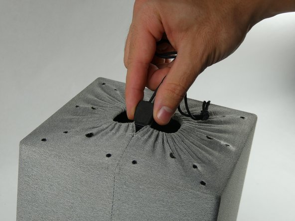

    • The gray mesh bag covering the speaker will now be exposed.
    • Flick the switch on the middle of the lock down to loosen the sack.
    • Pull upwards on the locking mechanism to loosen the drawstring. Stop pulling when the mesh bag is loose enough that it can be pulled downwards.
