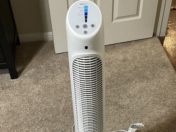

    • Start with turning the fan on its side along the floor.

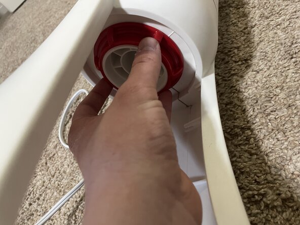

  2. Deep Cleaning a Honeywell HYF260 Tower Fan: crwdns2935265:02crwdnd2935265:01crwdnd2935265:03crwdne2935265:0 Deep Cleaning a Honeywell HYF260 Tower Fan: crwdns2935265:02crwdnd2935265:02crwdnd2935265:03crwdne2935265:0 Deep Cleaning a Honeywell HYF260 Tower Fan: crwdns2935265:02crwdnd2935265:03crwdnd2935265:03crwdne2935265:0
    • Twist the red locking mechanism at the bottom to the left. It should come off with ease, and the base should detach afterwards.
