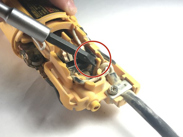

    • Pull back the tab holding the switch box in place using a nylon spudger. There is one on top and bottom shown in the image.

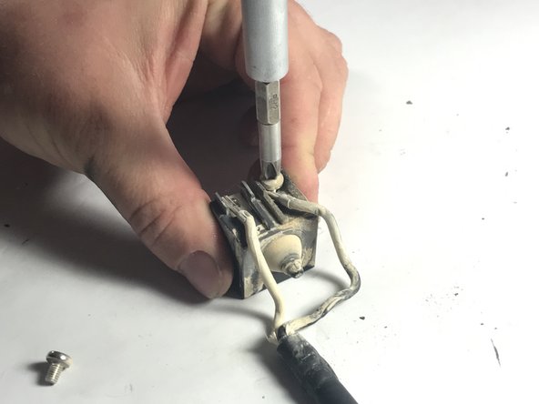

    • Using a small Phillips head screwdriver, remove the screws that hold the white colored wires from the power cord in place.
