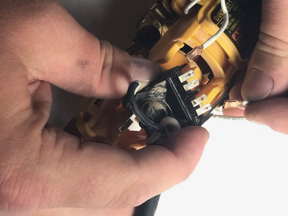

    • Pull back the yellow tab holding the housing in place using a nylon spudger. Carefully pull the housing out of the casing.
  6. DeWalt DWE4011 Power Cable Replacement: crwdns2935265:06crwdnd2935265:01crwdnd2935265:02crwdne2935265:0 DeWalt DWE4011 Power Cable Replacement: crwdns2935265:06crwdnd2935265:02crwdnd2935265:02crwdne2935265:0
    • Locate the terminals with the two white cables attached and disconnect both.
    • These cables are connected to the outer terminals; connect as such during reassembly.

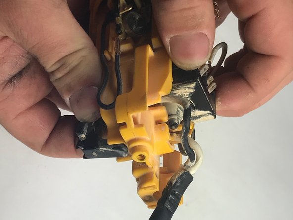

  7. DeWalt DWE4011 Power Cable Replacement: crwdns2935265:07crwdnd2935265:01crwdnd2935265:02crwdne2935265:0 DeWalt DWE4011 Power Cable Replacement: crwdns2935265:07crwdnd2935265:02crwdnd2935265:02crwdne2935265:0
    • Remove the entirety of the cable housing from the device casing.
    • The two wires coming from the power cable should still be connected to electrical housing at this point.
  8. DeWalt DWE4011 Power Cable Replacement: crwdns2935265:08crwdnd2935265:01crwdnd2935265:01crwdne2935265:0
    • Loosen the Phillips #2 screws enough to disconnect the two wires from the power cable housing.
    • Removing the screw entirely is fine, but unnecessary since the screws are merely clamping down the wires' ends.
