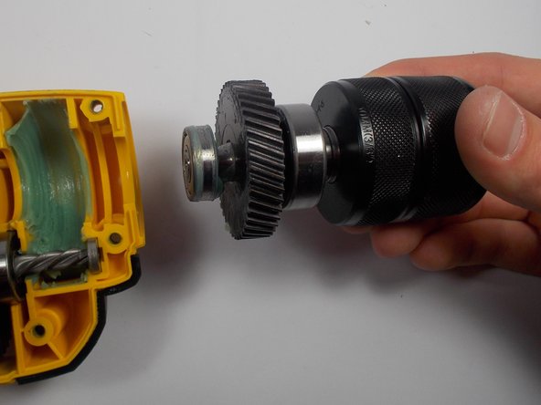

      • Take note of the keyless chuck and the meshing of the gears.
    2. DeWalt DWD112 Brush Replacement: crwdns2935265:09crwdnd2935265:01crwdnd2935265:02crwdne2935265:0 DeWalt DWD112 Brush Replacement: crwdns2935265:09crwdnd2935265:02crwdnd2935265:02crwdne2935265:0
      • Grab the metal chuck by the rotating spindle as if you are to tighten in a drill bit.
      • Lift the metal chuck out of its resting place and set aside.

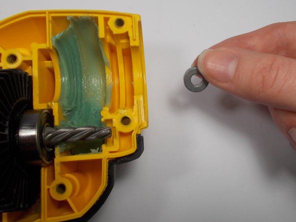

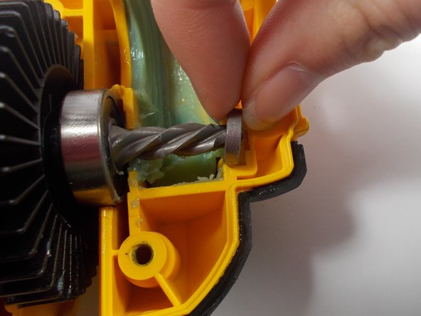

    3. DeWalt DWD112 Brush Replacement: crwdns2935265:010crwdnd2935265:01crwdnd2935265:03crwdne2935265:0 DeWalt DWD112 Brush Replacement: crwdns2935265:010crwdnd2935265:02crwdnd2935265:03crwdne2935265:0 DeWalt DWD112 Brush Replacement: crwdns2935265:010crwdnd2935265:03crwdnd2935265:03crwdne2935265:0
      • With your left hand, grab hold of the field, which is the large metal block with coils looped around the inside.
      • Use your other hand to take the bearing out from the end of the gear connected to the armature.

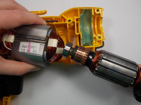

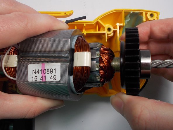

    4. DeWalt DWD112 Brush Replacement: crwdns2935265:011crwdnd2935265:01crwdnd2935265:03crwdne2935265:0 DeWalt DWD112 Brush Replacement: crwdns2935265:011crwdnd2935265:02crwdnd2935265:03crwdne2935265:0 DeWalt DWD112 Brush Replacement: crwdns2935265:011crwdnd2935265:03crwdnd2935265:03crwdne2935265:0
      • Lift the field up once more with one hand and grab the cooling fan with the other hand and gently slide the armature out of the field.
      • The brushes will now be disconnected from the armature, meaning no current can flow from the power cord to the motor.

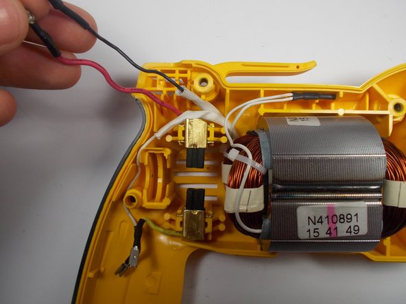

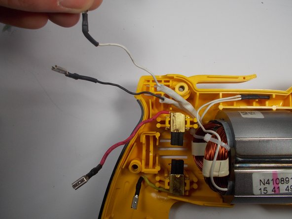

    1. DeWalt DWD112 Brush Replacement, Field: crwdns2935265:012crwdnd2935265:01crwdnd2935265:03crwdne2935265:0 DeWalt DWD112 Brush Replacement, Field: crwdns2935265:012crwdnd2935265:02crwdnd2935265:03crwdne2935265:0 DeWalt DWD112 Brush Replacement, Field: crwdns2935265:012crwdnd2935265:03crwdnd2935265:03crwdne2935265:0
      • Move the black wire clear from any obstruction.
      • Repeat this step for the white wire and the red wire.

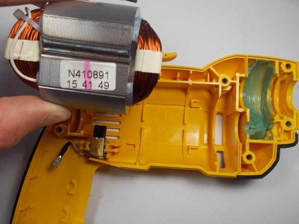

    2. DeWalt DWD112 Brush Replacement: crwdns2935265:013crwdnd2935265:01crwdnd2935265:02crwdne2935265:0 DeWalt DWD112 Brush Replacement: crwdns2935265:013crwdnd2935265:02crwdnd2935265:02crwdne2935265:0
      • The field is disconnected from all other parts.
      • Grab the field and gently lift it out of the case.

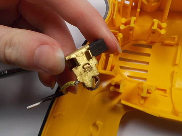

    1. DeWalt DWD112 Brush Replacement, Brush: crwdns2935265:014crwdnd2935265:01crwdnd2935265:02crwdne2935265:0 DeWalt DWD112 Brush Replacement, Brush: crwdns2935265:014crwdnd2935265:02crwdnd2935265:02crwdne2935265:0
      • Using two fingers, press the brush into the metal casing.
      • Firmly pull out the brush using the same two fingers.
    2. DeWalt DWD112 Brush Replacement: crwdns2935265:015crwdnd2935265:01crwdnd2935265:02crwdne2935265:0 DeWalt DWD112 Brush Replacement: crwdns2935265:015crwdnd2935265:02crwdnd2935265:02crwdne2935265:0
      • Repeat the same process to remove the second brush.
