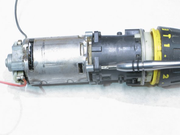

  5. DeWalt DW997 Motor Replacement, Motor: crwdns2935265:05crwdnd2935265:01crwdnd2935265:02crwdne2935265:0 DeWalt DW997 Motor Replacement, Motor: crwdns2935265:05crwdnd2935265:02crwdnd2935265:02crwdne2935265:0
    • Use a Torx T10 screw bit to remove the four 11mm screws around the motor.

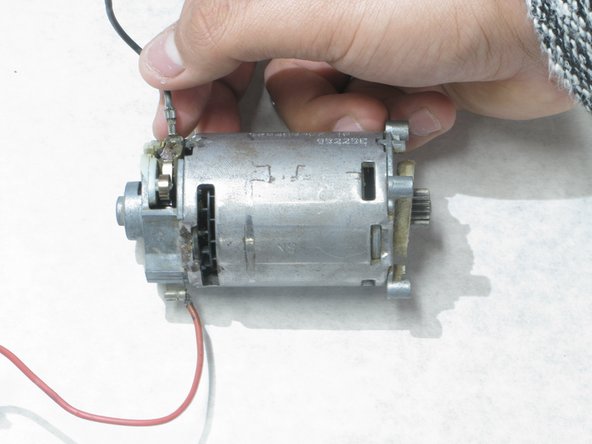

  6. DeWalt DW997 Motor Replacement: crwdns2935265:06crwdnd2935265:01crwdnd2935265:02crwdne2935265:0 DeWalt DW997 Motor Replacement: crwdns2935265:06crwdnd2935265:02crwdnd2935265:02crwdne2935265:0
    • Pull off the two wires that connect the motor to the trigger.
    • Be careful while pulling the wires as they can tear.
