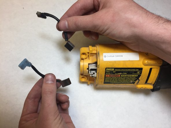

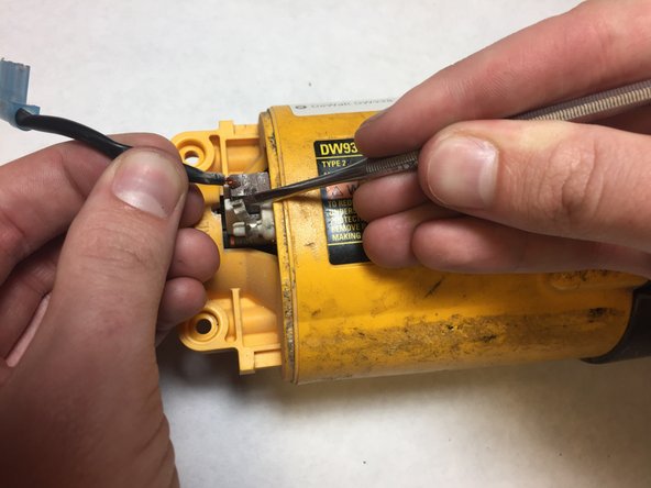

  7. DeWalt DW938 Brush Head Replacement, Brush Head: crwdns2935265:07crwdnd2935265:01crwdnd2935265:03crwdne2935265:0 DeWalt DW938 Brush Head Replacement, Brush Head: crwdns2935265:07crwdnd2935265:02crwdnd2935265:03crwdne2935265:0 DeWalt DW938 Brush Head Replacement, Brush Head: crwdns2935265:07crwdnd2935265:03crwdnd2935265:03crwdne2935265:0
    • Push in locking clips to remove the brush head.
    • Repeat for the other brush.
