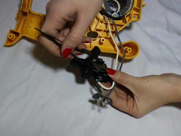

  8. DeWalt DW936 Trigger Replacement: crwdns2935265:08crwdnd2935265:01crwdnd2935265:01crwdne2935265:0
    • The trigger should be able to sit freely.
  9. DeWalt DW936 Trigger Replacement: crwdns2935265:09crwdnd2935265:01crwdnd2935265:02crwdne2935265:0 DeWalt DW936 Trigger Replacement: crwdns2935265:09crwdnd2935265:02crwdnd2935265:02crwdne2935265:0
    • Lift off the silver metal piece using tweezers.
    • Lift off each hook. (4 corners)
  10. DeWalt DW936 Trigger Replacement: crwdns2935265:010crwdnd2935265:01crwdnd2935265:01crwdne2935265:0
    • Pull plastic trigger out of the black plastic casing.
