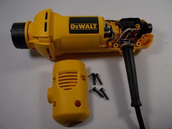

  4. DeWalt DW660 Bearings Replacement: crwdns2935265:04crwdnd2935265:01crwdnd2935265:02crwdne2935265:0 DeWalt DW660 Bearings Replacement: crwdns2935265:04crwdnd2935265:02crwdnd2935265:02crwdne2935265:0
    • Unscrew the four 19mm T20 Torx screws on the motor shroud.
    • Carefully remove the shroud from the body.
    • When removing the shroud, the spring that operates lock #2 may pop out.

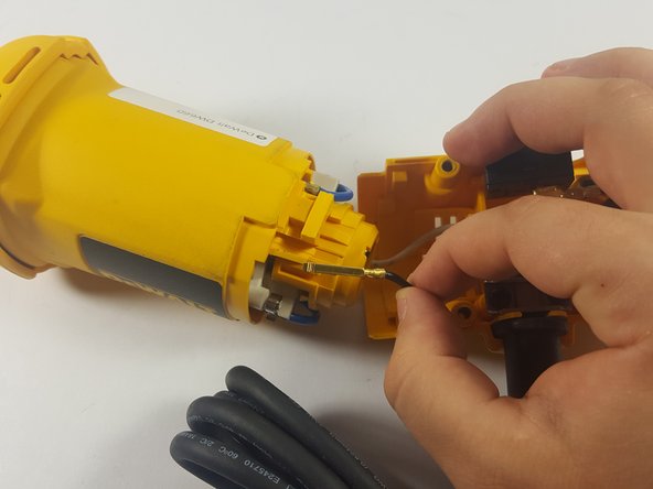

  5. DeWalt DW660 Bearings Replacement: crwdns2935265:05crwdnd2935265:01crwdnd2935265:03crwdne2935265:0 DeWalt DW660 Bearings Replacement: crwdns2935265:05crwdnd2935265:02crwdnd2935265:03crwdne2935265:0 DeWalt DW660 Bearings Replacement: crwdns2935265:05crwdnd2935265:03crwdnd2935265:03crwdne2935265:0
    • Unscrew the four 19mm T20 Torx screws on the side of the back end of the DW660.
    • Take apart the back two halves.
    • Using two fingers, pull the black and white power wires from the motor to completely disconnect the back half of the device.
