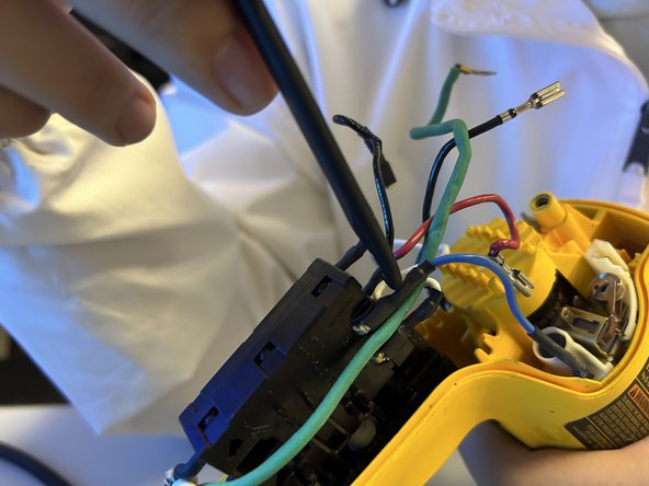

    • Disconnect all the wires connected from the trigger box and power cord to the drill motor by pulling on the connectors.
    • There will be 5 wires to disconnect: 2 black, a white, a red, and a blue wire. Remember the locations of where they were connected so you can reconnect them later.
  4. DeWalt DW235G Drill Power Cord Replacement: crwdns2935265:04crwdnd2935265:01crwdnd2935265:01crwdne2935265:0
    • Remove the trigger box and power cord from the main chassis.
  5. DeWalt DW235G Drill Power Cord Replacement: crwdns2935265:05crwdnd2935265:01crwdnd2935265:01crwdne2935265:0
    • Disconnect the wires connecting the power cord to the trigger box by pressing on the clips with a spudger tool.
    • There will be 3 wires to disconnect: A black, white, and green wire. Remember what color attaches to each connector on the trigger box.
    • For reassembly, insert the wires back into the trigger box until a click is heard.
The power cord will now be disconnect and you can replace it with a new one.
