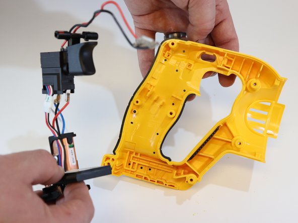

      • Remove the top half of the grip.
      • Turn the saw over and locate the power connectors to the motor.
      • Use needle nose pliers to remove the spade connectors. Take care not to grab the wires on removal, only the end of the spade terminal.
      • Note the polarity for the power connectors and be sure they are not reversed on reassembly.

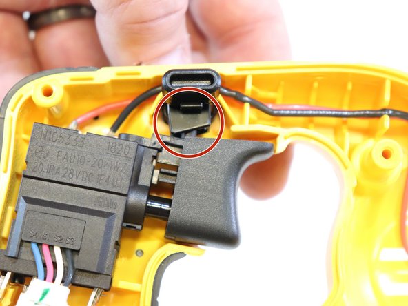

    1. DeWalt DCS380 Trigger assembly Replacement, Trigger assembly: crwdns2935265:03crwdnd2935265:01crwdnd2935265:03crwdne2935265:0 DeWalt DCS380 Trigger assembly Replacement, Trigger assembly: crwdns2935265:03crwdnd2935265:02crwdnd2935265:03crwdne2935265:0 DeWalt DCS380 Trigger assembly Replacement, Trigger assembly: crwdns2935265:03crwdnd2935265:03crwdnd2935265:03crwdne2935265:0
      • Take note of the position of the battery tension spring and safety switch before removal.
      • Lift the trigger assembly out of the grip.
