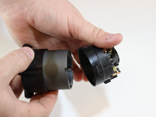

  8. DeWalt DCS380 Motor Brush Replacement: crwdns2935265:08crwdnd2935265:01crwdnd2935265:02crwdne2935265:0 DeWalt DCS380 Motor Brush Replacement: crwdns2935265:08crwdnd2935265:02crwdnd2935265:02crwdne2935265:0
    • Remove two M3.63x60mm T10 bolts from the inner edge of the motor case.
    • Pull the brush housing off the top, leaving the bottom half in place.
  9. DeWalt DCS380 Motor Brush Replacement: crwdns2935265:09crwdnd2935265:01crwdnd2935265:03crwdne2935265:0 DeWalt DCS380 Motor Brush Replacement: crwdns2935265:09crwdnd2935265:02crwdnd2935265:03crwdne2935265:0 DeWalt DCS380 Motor Brush Replacement: crwdns2935265:09crwdnd2935265:03crwdnd2935265:03crwdne2935265:0
    • This step is for reassembly of the motor.
    • Use tweezers to unload the springs from the new set of brushes.
    • Pull the brush heads back as far as the casing will allow.
    • Reload the springs after the armature has be re-seated.
    • Do not force the armature into the case. With all the brushes pulled back, it should slide in smoothly. Forcing the armature past the brushes can damage them or render them inoperable.
