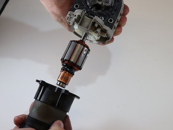

  6. DeWalt DCS380 Motor Armature Replacement, Motor Armature: crwdns2935265:06crwdnd2935265:01crwdnd2935265:02crwdne2935265:0 DeWalt DCS380 Motor Armature Replacement, Motor Armature: crwdns2935265:06crwdnd2935265:02crwdnd2935265:02crwdne2935265:0
    • Remove three M8x18 T20 bolts from the back of the gearbox.
    • Pull the motor case off of the armature.

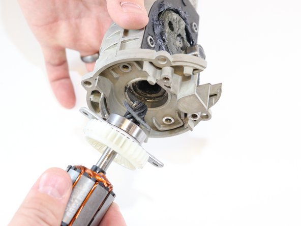

  7. DeWalt DCS380 Motor Armature Replacement: crwdns2935265:07crwdnd2935265:01crwdnd2935265:02crwdne2935265:0 DeWalt DCS380 Motor Armature Replacement: crwdns2935265:07crwdnd2935265:02crwdnd2935265:02crwdne2935265:0
    • Remove two M8x12mm T20 bolts from the bearing retainer.
    • Pull the shaft out of the gearbox.
    • Please note, the brushes will need to be disengaged to reassemble the motor. See the end of the Motor Brush replacement section of this guide for details.
