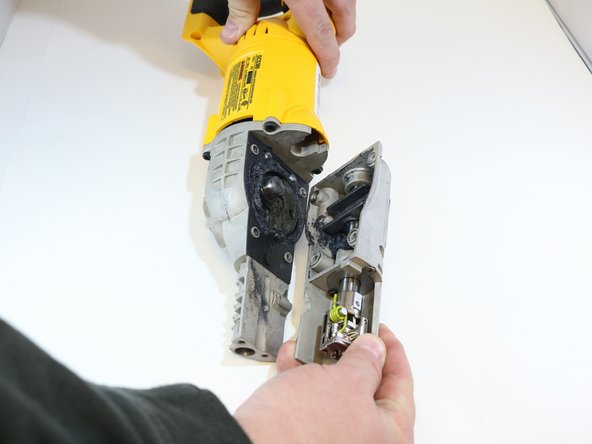

  4. DeWalt DCS380 Blade Shaft Replacement, Blade Shaft: crwdns2935265:04crwdnd2935265:01crwdnd2935265:02crwdne2935265:0 DeWalt DCS380 Blade Shaft Replacement, Blade Shaft: crwdns2935265:04crwdnd2935265:02crwdnd2935265:02crwdne2935265:0
    • Remove the four M8x18mm T20 screws on the top of the gearbox.
    • Pull the top of the gearbox off and set the saw body aside.

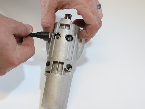

  5. DeWalt DCS380 Blade Shaft Replacement: crwdns2935265:05crwdnd2935265:01crwdnd2935265:02crwdne2935265:0 DeWalt DCS380 Blade Shaft Replacement: crwdns2935265:05crwdnd2935265:02crwdnd2935265:02crwdne2935265:0
    • Remove the black plastic dust covers using the plastic pry bar.
    • Remove the two M5 lock nuts using a 5/16" socket.

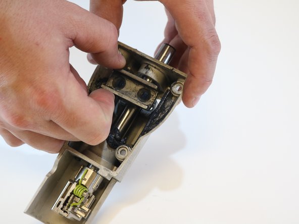

  6. DeWalt DCS380 Blade Shaft Replacement: crwdns2935265:06crwdnd2935265:01crwdnd2935265:02crwdne2935265:0 DeWalt DCS380 Blade Shaft Replacement: crwdns2935265:06crwdnd2935265:02crwdnd2935265:02crwdne2935265:0
    • Turn the housing over and remove the two countersunk M5x17mm T20 bolts from the shaft yoke.
    • Remove the yoke.

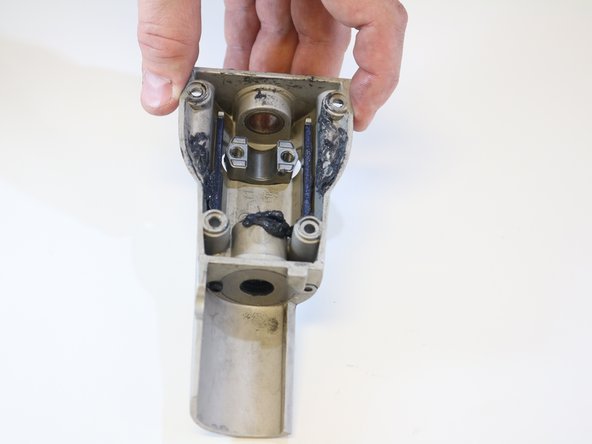

  7. DeWalt DCS380 Blade Shaft Replacement: crwdns2935265:07crwdnd2935265:01crwdnd2935265:02crwdne2935265:0 DeWalt DCS380 Blade Shaft Replacement: crwdns2935265:07crwdnd2935265:02crwdnd2935265:02crwdne2935265:0
    • Pull the shaft out of the front of the housing.
    • Leave the shaft saddle in place over the holes in the cover.
    • Re-grease before re-assembly. If there are metal shavings or pieces of the broken shaft left in the gearbox make sure to remove them before re-greasing.
