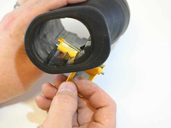

DeWalt DCS380 Blade Release lever Replacement
  1. DeWalt DCS380 Blade Release lever Replacement, Removing shoe and boot.: crwdns2935265:01crwdnd2935265:01crwdnd2935265:01crwdne2935265:0
    • Remove the battery before disassembly.
    • Remove the shoe by pressing the yellow button on the left side of the hand grip.
  2. DeWalt DCS380 Blade Release lever Replacement: crwdns2935265:02crwdnd2935265:01crwdnd2935265:02crwdne2935265:0 DeWalt DCS380 Blade Release lever Replacement: crwdns2935265:02crwdnd2935265:02crwdnd2935265:02crwdne2935265:0
    • Remove the two M8x18mm T20 bolts from the front plate.
  3. DeWalt DCS380 Blade Release lever Replacement: crwdns2935265:03crwdnd2935265:01crwdnd2935265:01crwdne2935265:0
    • Pull the front of the grip while holding the saw body in place.
  4. DeWalt DCS380 Blade Release lever Replacement, Blade Release lever: crwdns2935265:04crwdnd2935265:01crwdnd2935265:02crwdne2935265:0 DeWalt DCS380 Blade Release lever Replacement, Blade Release lever: crwdns2935265:04crwdnd2935265:02crwdnd2935265:02crwdne2935265:0
    • Fold the lever all the way back and push it out of the boot.
