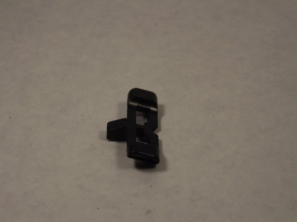

    1. DeWalt DC970 Forward/Reverse switch Replacement, Forward/Reverse switch: crwdns2935265:05crwdnd2935265:01crwdnd2935265:01crwdne2935265:0
      • Remove the drill mechanism from the shell.
    2. DeWalt DC970 Forward/Reverse switch Replacement: crwdns2935265:06crwdnd2935265:01crwdnd2935265:02crwdne2935265:0 DeWalt DC970 Forward/Reverse switch Replacement: crwdns2935265:06crwdnd2935265:02crwdnd2935265:02crwdne2935265:0
      • Disconnect the forward/reverse switch from the trigger by pulling the mechanism out and leaving the switch in the frame.
      • To replace just pull the switch out and put the new one in the opening.
