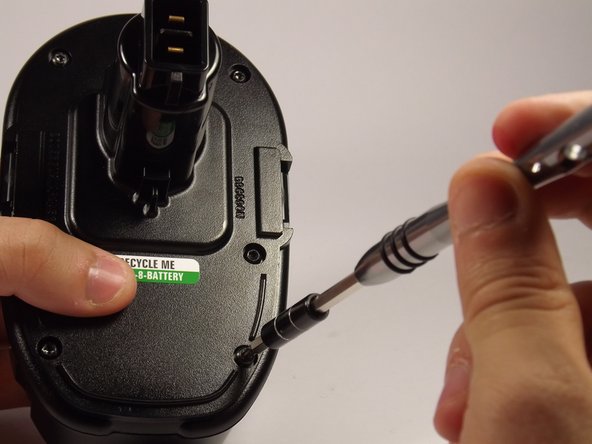

    • Remove the six 19 mm, Torx Security 15 screws from the top of the battery.

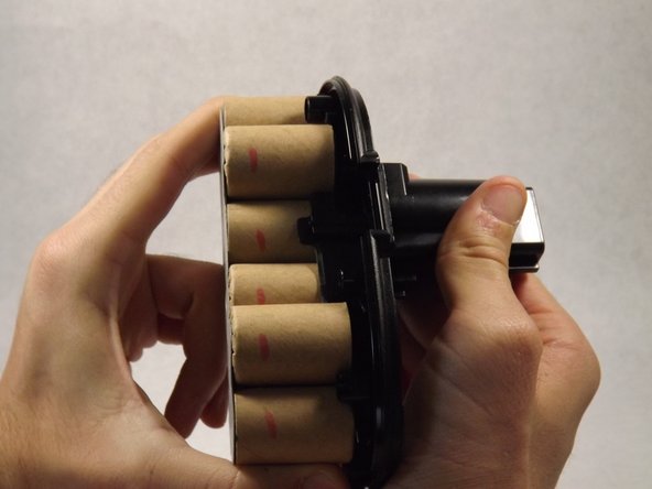

  4. DeWalt DC970 Battery Cells Replacement: crwdns2935265:04crwdnd2935265:01crwdnd2935265:01crwdne2935265:0
    • Pull off the battery cover, exposing the battery cells.
    • Be careful to not damage the batteries, if damaged they may explode.

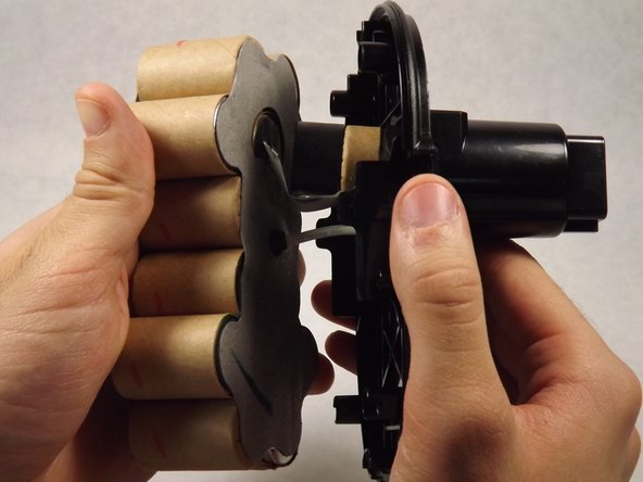

  5. DeWalt DC970 Battery Cells Replacement: crwdns2935265:05crwdnd2935265:01crwdnd2935265:03crwdne2935265:0 DeWalt DC970 Battery Cells Replacement: crwdns2935265:05crwdnd2935265:02crwdnd2935265:03crwdne2935265:0 DeWalt DC970 Battery Cells Replacement: crwdns2935265:05crwdnd2935265:03crwdnd2935265:03crwdne2935265:0
    • Remove the old battery cells by slowly pulling them out of the top piece of the battery.
    • The best is to recycle the old battery cells.
