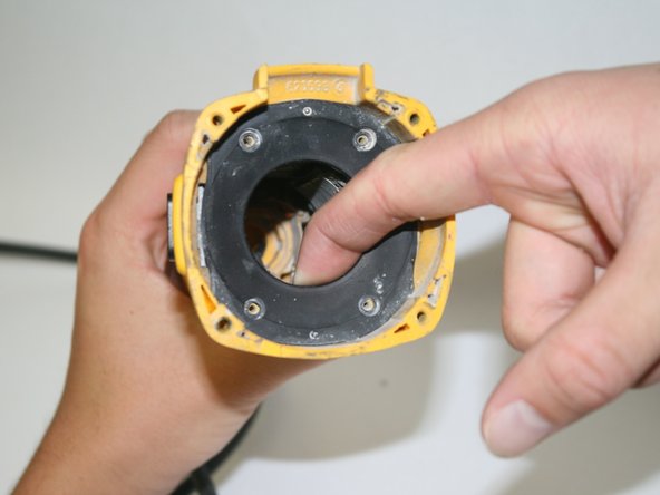

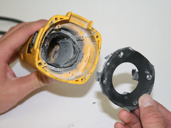

      • There is an inner plastic guard behind the motor shaft.
      • Unscrew the four screws at each corner.
      • The guard should pull out with a good firm tug.

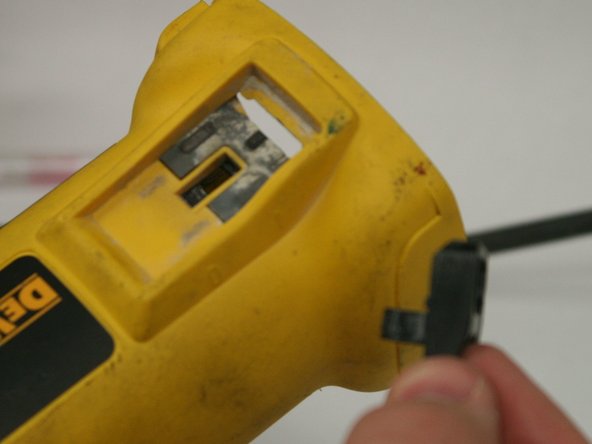

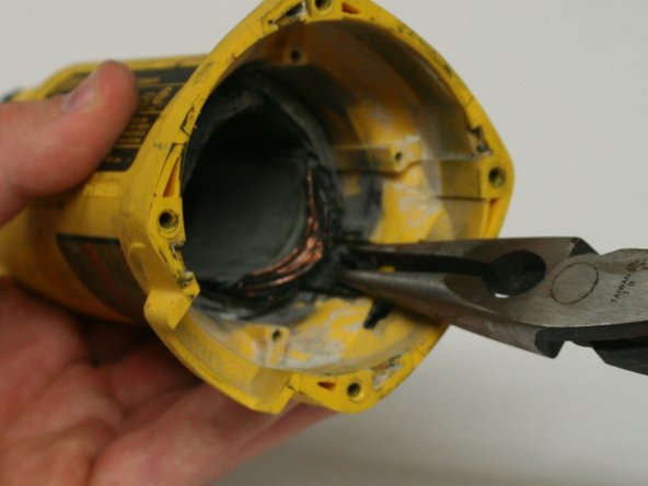

      • Just behind the inner guard is the button slide.
      • Use needle nose pliers to pinch and push the button's flanges together, and out of the slot.

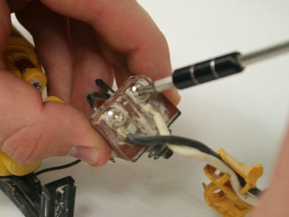

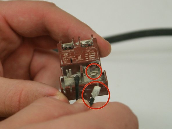

      • Using the J-1 screwdriver, unscrew the power cord wires from the red switch box (located in the back of the grinder).
    4. DeWalt D28110 Power Switch Replacement: crwdns2935265:010crwdnd2935265:01crwdnd2935265:02crwdne2935265:0 DeWalt D28110 Power Switch Replacement: crwdns2935265:010crwdnd2935265:02crwdnd2935265:02crwdne2935265:0

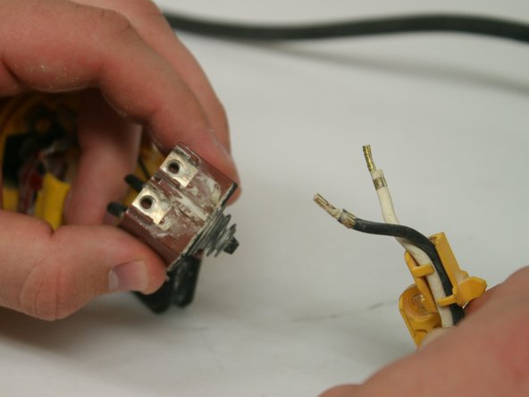

      • Disconnect the motor wires from the other side of the switch box.
      • They wires are connected as a sleeve to the flat pin out of the switch box. A firm pull should do it.
