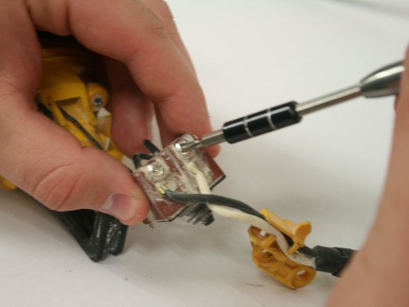

  5. DeWalt D28110 Power Cord Replacement, Power Cord: crwdns2935265:05crwdnd2935265:01crwdnd2935265:03crwdne2935265:0 DeWalt D28110 Power Cord Replacement, Power Cord: crwdns2935265:05crwdnd2935265:02crwdnd2935265:03crwdne2935265:0 DeWalt D28110 Power Cord Replacement, Power Cord: crwdns2935265:05crwdnd2935265:03crwdnd2935265:03crwdne2935265:0
    • Locate the red switch box.
    • Using the J-10 screwdriver, unscrew the screws and detach the wires.
    • Be sure to remember under which screw the "ground" wire (black) goes.
  6. DeWalt D28110 Power Cord Replacement: crwdns2935265:06crwdnd2935265:01crwdnd2935265:01crwdne2935265:0
    • Unthread the two wires from the power cord clamp.
