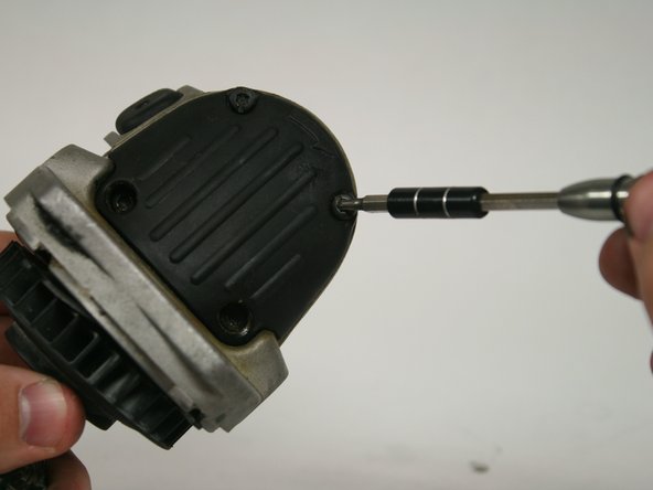

    • Using the T-15 screwdriver, remove the four 22-mm torx screws on the gear case.
    • Unplug the grinder before any disassembly.

  3. DeWalt D28110 Pinion Replacement, Pinion: crwdns2935265:03crwdnd2935265:01crwdnd2935265:02crwdne2935265:0 DeWalt D28110 Pinion Replacement, Pinion: crwdns2935265:03crwdnd2935265:02crwdnd2935265:02crwdne2935265:0
    • Using the T-15 screwdriver, remove the four torx screws.
  4. DeWalt D28110 Pinion Replacement: crwdns2935265:04crwdnd2935265:01crwdnd2935265:01crwdne2935265:0
    • Remove the gear case cover from the gear case.
