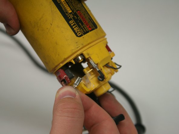

  5. DeWalt D28110 Brush and Spring Replacement, Brush and Spring: crwdns2935265:05crwdnd2935265:01crwdnd2935265:02crwdne2935265:0 DeWalt D28110 Brush and Spring Replacement, Brush and Spring: crwdns2935265:05crwdnd2935265:02crwdnd2935265:02crwdne2935265:0
    • Gently pull to disconnect brush connector.

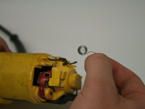

  6. DeWalt D28110 Brush and Spring Replacement: crwdns2935265:06crwdnd2935265:01crwdnd2935265:02crwdne2935265:0 DeWalt D28110 Brush and Spring Replacement: crwdns2935265:06crwdnd2935265:02crwdnd2935265:02crwdne2935265:0
    • Use the edge of the spudger to slide the spring off its post.
  7. DeWalt D28110 Brush and Spring Replacement: crwdns2935265:07crwdnd2935265:01crwdnd2935265:01crwdne2935265:0
    • Use tweezers to gently remove the brush and cable.
