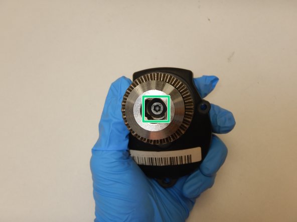

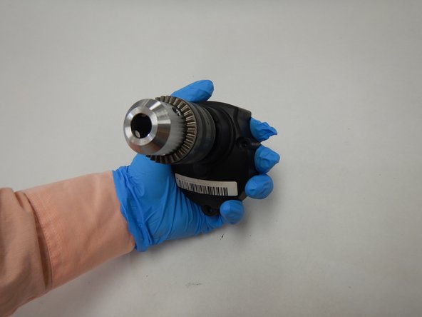

  5. DeWALT Hammer Drill DW511 Chuck Replacement, Chuck: crwdns2935265:05crwdnd2935265:01crwdnd2935265:03crwdne2935265:0 DeWALT Hammer Drill DW511 Chuck Replacement, Chuck: crwdns2935265:05crwdnd2935265:02crwdnd2935265:03crwdne2935265:0 DeWALT Hammer Drill DW511 Chuck Replacement, Chuck: crwdns2935265:05crwdnd2935265:03crwdnd2935265:03crwdne2935265:0
    • Gently separate the chuck and plastic housing from the hammer drill body.
    • The removal of the screw from the chuck to separate the plastic housing requires hand strength and specialized tools.
    • The plastic housing is prone to damage if excessive force is applied during the replacement.
