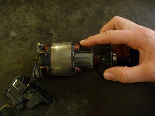

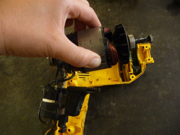

    • Disengage and remove the spindle and gear assembly.
    • Lift out the field assembly and armature.
  4. DeWALT DW106 Amp Drill Maintenance: crwdns2935265:04crwdnd2935265:01crwdnd2935265:03crwdne2935265:0 DeWALT DW106 Amp Drill Maintenance: crwdns2935265:04crwdnd2935265:02crwdnd2935265:03crwdne2935265:0 DeWALT DW106 Amp Drill Maintenance: crwdns2935265:04crwdnd2935265:03crwdnd2935265:03crwdne2935265:0

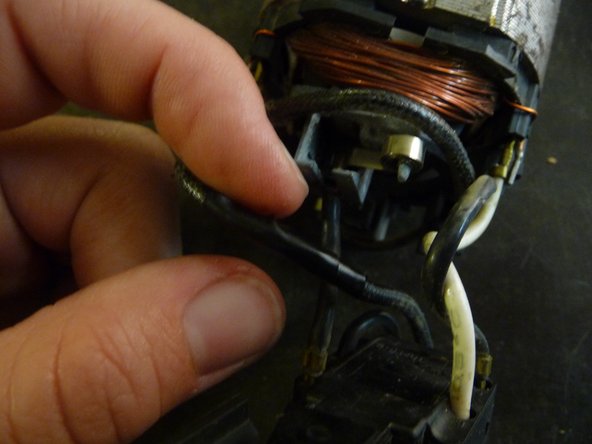

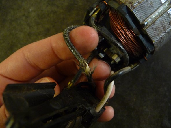

    • Slide the armature out of the field assembly.

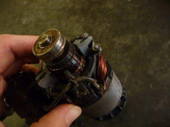

    • Rotate the field assembly to lay on the top. This allows for easier access to the frayed wire.
  5. DeWALT DW106 Amp Drill Maintenance: crwdns2935265:05crwdnd2935265:01crwdnd2935265:03crwdne2935265:0 DeWALT DW106 Amp Drill Maintenance: crwdns2935265:05crwdnd2935265:02crwdnd2935265:03crwdne2935265:0 DeWALT DW106 Amp Drill Maintenance: crwdns2935265:05crwdnd2935265:03crwdnd2935265:03crwdne2935265:0

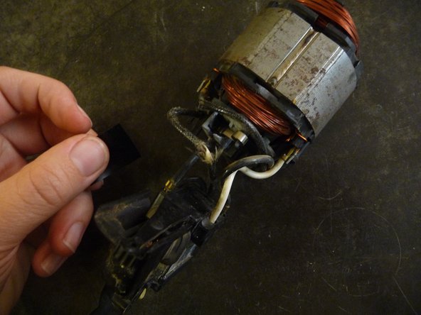

    • Cut a piece of electrical tape about one inch long.
    • Wrap it tightly around the frayed section of the wiring.
    • It is easier to start with one of the corners and wrap the tape at an angle.

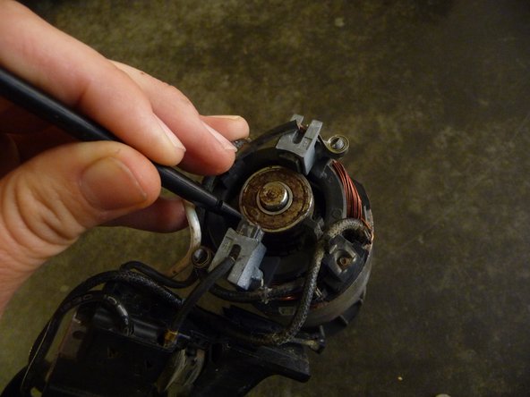

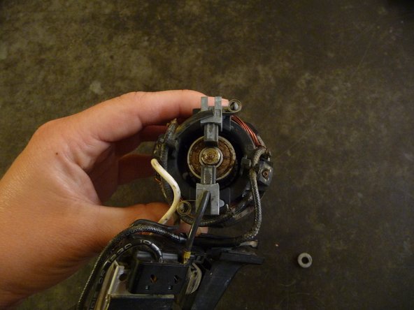

    • Compress the brushes in the brush ring so the ball bearing at the end of the armature assembly can get through.
    • Use a spudger or similar thin tool.
    • Side view. This is not far enough.
  8. DeWALT DW106 Amp Drill Maintenance: crwdns2935265:08crwdnd2935265:01crwdnd2935265:02crwdne2935265:0 DeWALT DW106 Amp Drill Maintenance: crwdns2935265:08crwdnd2935265:02crwdnd2935265:02crwdne2935265:0
    • Reaching from the sides, use the spudger to insert the armature even farther.
    • Side view. This is far enough.
