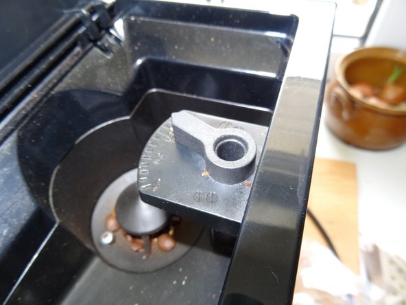

  3. DeLonghi ESAM  xxxx Solenoid Replacement, Adjuster: crwdns2935265:03crwdnd2935265:01crwdnd2935265:03crwdne2935265:0 DeLonghi ESAM  xxxx Solenoid Replacement, Adjuster: crwdns2935265:03crwdnd2935265:02crwdnd2935265:03crwdne2935265:0 DeLonghi ESAM  xxxx Solenoid Replacement, Adjuster: crwdns2935265:03crwdnd2935265:03crwdnd2935265:03crwdne2935265:0
    • Remove the cap, then unscrew the exposed screw. Take away the adjuster.
    • Now you can remove the top of the machine.
