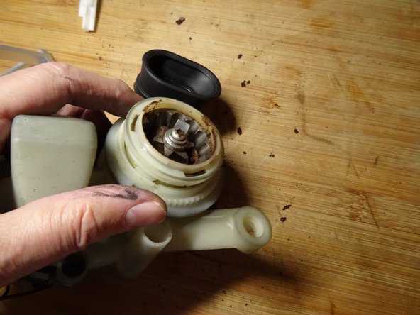

    • If the bean hopper is still attached, it must be removed.
    • Use a pointed tool to remove the cap on the adjustment dial.
  2. DeLonghi  Coffee Maker grindstones replacement: crwdns2935265:02crwdnd2935265:01crwdnd2935265:03crwdne2935265:0 DeLonghi  Coffee Maker grindstones replacement: crwdns2935265:02crwdnd2935265:02crwdnd2935265:03crwdne2935265:0 DeLonghi  Coffee Maker grindstones replacement: crwdns2935265:02crwdnd2935265:03crwdnd2935265:03crwdne2935265:0
    • There is a Phillips screw underneath. Unscrew it.
    • Note the position and pull the dial upwards.
    • Pull the bean container upwards.
    • On some models, there are two more Phillips screws in the bean hopper.

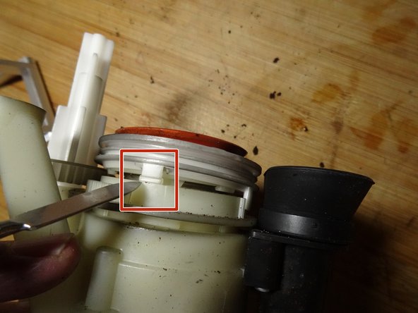

  3. DeLonghi  Coffee Maker grindstones replacement: crwdns2935265:03crwdnd2935265:01crwdnd2935265:03crwdne2935265:0 DeLonghi  Coffee Maker grindstones replacement: crwdns2935265:03crwdnd2935265:02crwdnd2935265:03crwdne2935265:0 DeLonghi  Coffee Maker grindstones replacement: crwdns2935265:03crwdnd2935265:03crwdnd2935265:03crwdne2935265:0
    • Mark the settings of the wheels with a pencil.
    • Use a spatula to loosen the two detents on the sides.
    • Pull off the red silicone seal.

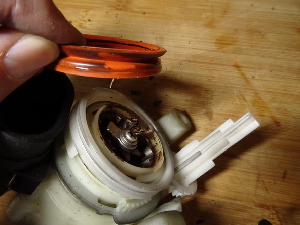

  4. DeLonghi  Coffee Maker grindstones replacement: crwdns2935265:04crwdnd2935265:01crwdnd2935265:03crwdne2935265:0 DeLonghi  Coffee Maker grindstones replacement: crwdns2935265:04crwdnd2935265:02crwdnd2935265:03crwdne2935265:0 DeLonghi  Coffee Maker grindstones replacement: crwdns2935265:04crwdnd2935265:03crwdnd2935265:03crwdne2935265:0
    • Lift off the white plastic ring.
    • Turn the white ring with the ring gear counterclockwise as far as it will go.
    • The grinding ring is free and you can lift it out upwards.

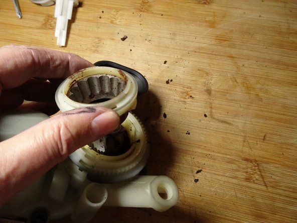

  5. DeLonghi  Coffee Maker grindstones replacement: crwdns2935265:05crwdnd2935265:01crwdnd2935265:01crwdne2935265:0
    • The grinding ring can be completely removed from the plastic holder. To do this, lift the three detents to the side and push the ring out.
    • The ring has three flattened sides. Unfortunately, such a ring is not commercially available anywhere. If it is still good, you may be able to use it in another mill.

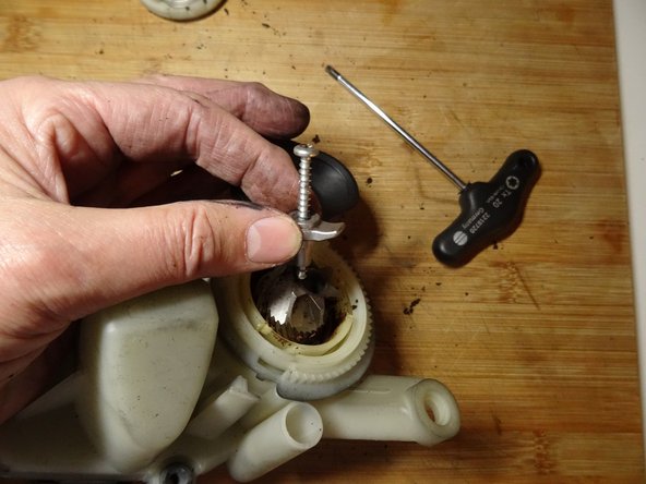

  6. DeLonghi  Coffee Maker grindstones replacement: crwdns2935265:06crwdnd2935265:01crwdnd2935265:02crwdne2935265:0 DeLonghi  Coffee Maker grindstones replacement: crwdns2935265:06crwdnd2935265:02crwdnd2935265:02crwdne2935265:0
    • The grinding cone is fastened with a Torx T20 screw with left-hand thread.
    • Unscrew the screw clockwise, i.e. the wrong way round.
    • When assembling, make sure that the screw with its fastening part fits exactly into the intended groove.

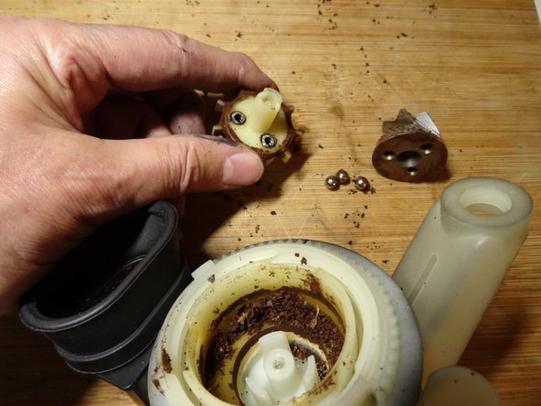

    • There are three metal balls on springs under the grinding cone. They are stuck in three sleeves in the plastic driver. Make sure that none of these parts get lost.
    • Lift the driver up and out.
    • Now you can clean all parts thoroughly.
    • When reassembling, make sure that the metal balls fit into the corresponding recesses in the cone.
