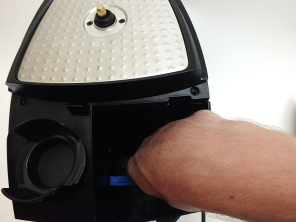

  7. De'Longhi EC155 Power Cord Replacement: crwdns2935265:07crwdnd2935265:01crwdnd2935265:02crwdne2935265:0 De'Longhi EC155 Power Cord Replacement: crwdns2935265:07crwdnd2935265:02crwdnd2935265:02crwdne2935265:0
    • Use a plastic opening tool to push in the slot on the back panel while lifting.
    • Similarly, reach into where the reservoir used to be and insert a plastic spudger underneath the inside panel.
    • We recommend to not use your fingers for this step because there is a chance they will be pinched.

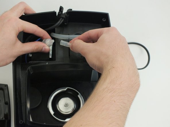

  9. De'Longhi EC155 Power Cord Replacement, Water Valve: crwdns2935265:09crwdnd2935265:01crwdnd2935265:02crwdne2935265:0 De'Longhi EC155 Power Cord Replacement, Water Valve: crwdns2935265:09crwdnd2935265:02crwdnd2935265:02crwdne2935265:0
    • Flip the device and remove one end of the tube from the water reservoir hole.
  10. De'Longhi EC155 Power Cord Replacement: crwdns2935265:010crwdnd2935265:01crwdnd2935265:02crwdne2935265:0 De'Longhi EC155 Power Cord Replacement: crwdns2935265:010crwdnd2935265:02crwdnd2935265:02crwdne2935265:0
    • Pull the tube through the chamber with the water pump so it comes out of the top end.
    • Twist the valve counterclockwise while pulling gently.

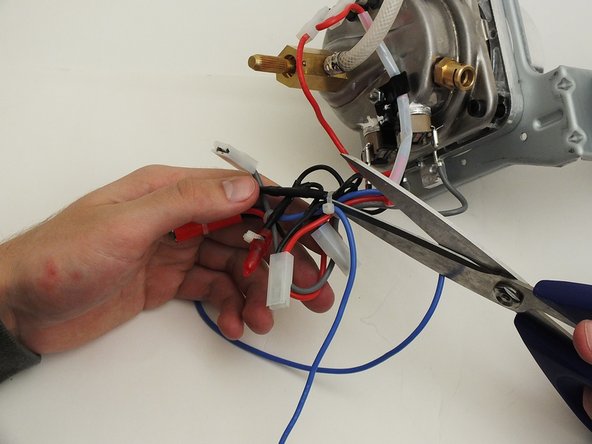

  18. De'Longhi EC155 Power Cord Replacement, Power Cord: crwdns2935265:018crwdnd2935265:01crwdnd2935265:02crwdne2935265:0 De'Longhi EC155 Power Cord Replacement, Power Cord: crwdns2935265:018crwdnd2935265:02crwdnd2935265:02crwdne2935265:0
    • Remove both sets of wires from the black box of the water pump.
    • Cut off the zip-tie holding all the wires together.
    • Isolate the blue wires from the rest and remove from core as necessary.
