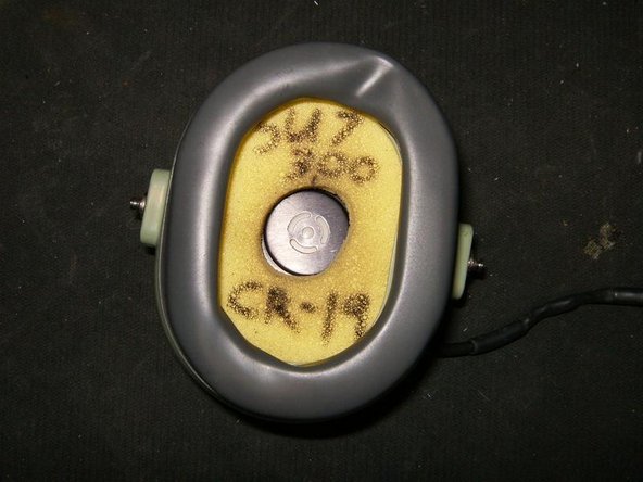

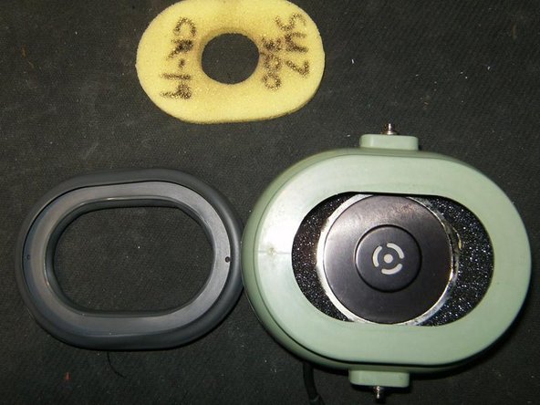

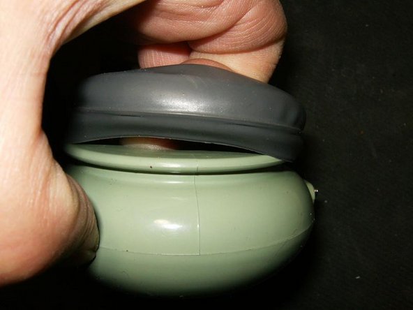

    • Here is the dome free of the stirrup.
    • The earseal is in decent condition. The filter (foam) shows plenty of wear and markings.
    • The earseal is held on by a groove in the dome. Simply pulling it off will release it.
  4. David Clark Over-Ear Headphones Right Dome Replacement: crwdns2935265:04crwdnd2935265:01crwdnd2935265:03crwdne2935265:0 David Clark Over-Ear Headphones Right Dome Replacement: crwdns2935265:04crwdnd2935265:02crwdnd2935265:03crwdne2935265:0 David Clark Over-Ear Headphones Right Dome Replacement: crwdns2935265:04crwdnd2935265:03crwdnd2935265:03crwdne2935265:0

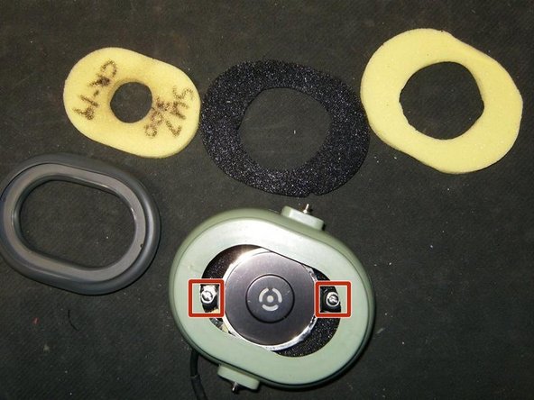

    • Earseal removed from dome, filter visible.

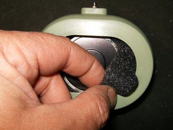

    • Next remove the filter (foam) to visualize the speaker.
    • Remove the next filter (foam) that is layered around the speaker
  5. David Clark Over-Ear Headphones Right Dome Replacement: crwdns2935265:05crwdnd2935265:01crwdnd2935265:03crwdne2935265:0 David Clark Over-Ear Headphones Right Dome Replacement: crwdns2935265:05crwdnd2935265:02crwdnd2935265:03crwdne2935265:0 David Clark Over-Ear Headphones Right Dome Replacement: crwdns2935265:05crwdnd2935265:03crwdnd2935265:03crwdne2935265:0
    • Filter removed, and another filter is visible around the speaker. The original headset will have three filters
    • One more filter under the speaker that needs to be removed.
    • The two screws that hold the speaker to the dome are clearly visible

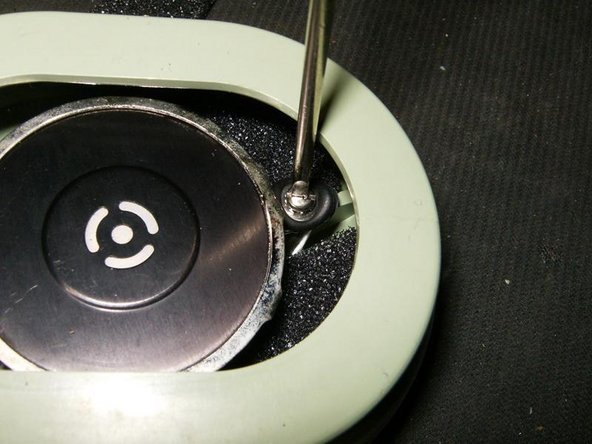

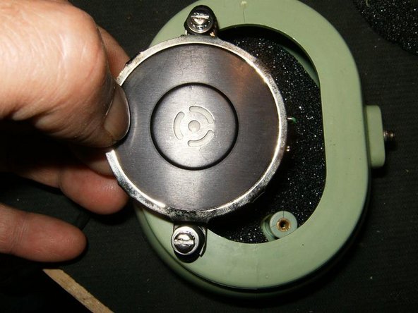

    • These are the two slotted screws that hold the speaker to the dome
    • Remove those with a flathead screw driver
    • Once the two screws are loose, lift the speaker out of the dome.

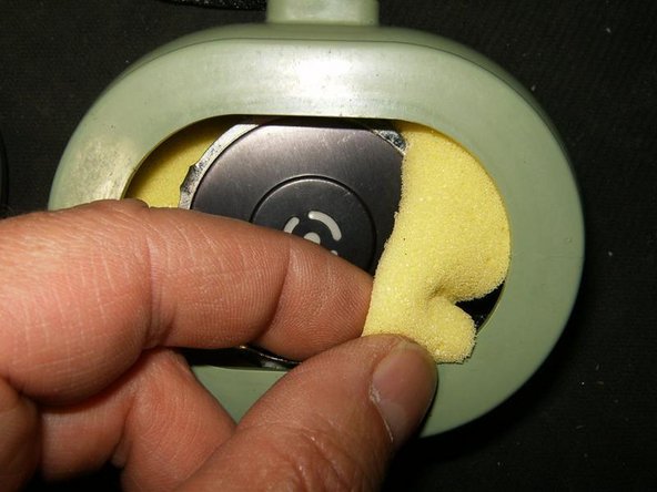

    • Flip the speaker out of the dome to remove the last filter.
    • With the speaker and the filter removed, damage to a standoff for the speaker becomes evident

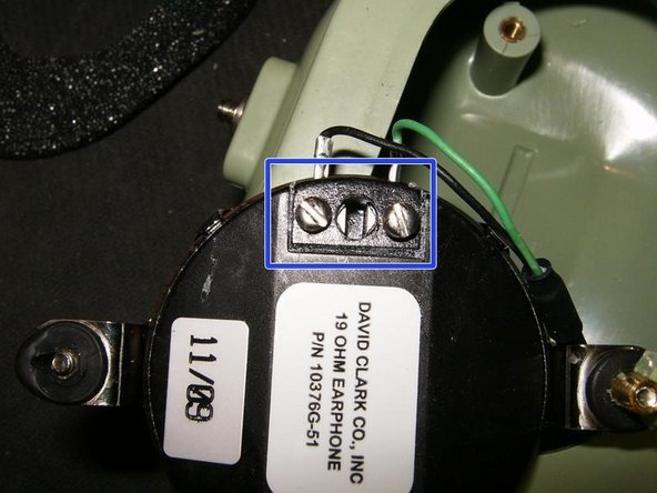

    • The speaker wires are held in place by two slotted screws
  8. David Clark Over-Ear Headphones Right Dome Replacement: crwdns2935265:08crwdnd2935265:01crwdnd2935265:03crwdne2935265:0 David Clark Over-Ear Headphones Right Dome Replacement: crwdns2935265:08crwdnd2935265:02crwdnd2935265:03crwdne2935265:0 David Clark Over-Ear Headphones Right Dome Replacement: crwdns2935265:08crwdnd2935265:03crwdnd2935265:03crwdne2935265:0
    • Loosen the two screws to remove the speaker

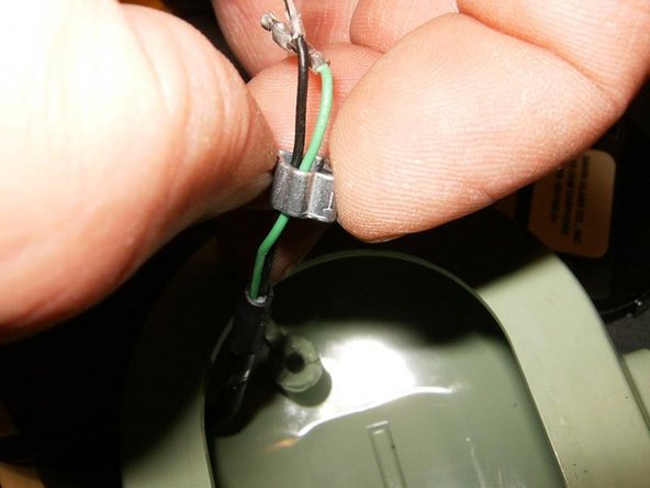

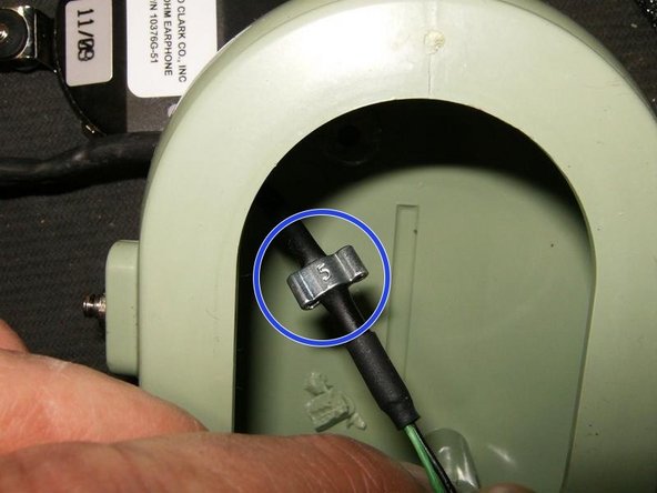

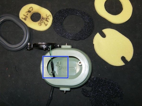

    • Pull the speaker wire (overhead cord) to the inside of the dome to free the cord clip

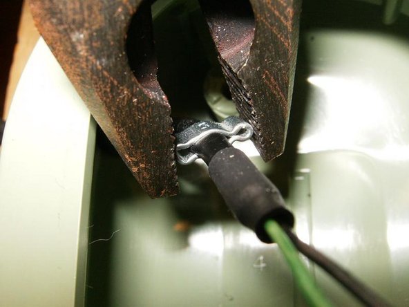

    • Using a pair of combination pliers, squeeze the two tabs of the cord clip
  9. David Clark Over-Ear Headphones Right Dome Replacement: crwdns2935265:09crwdnd2935265:01crwdnd2935265:03crwdne2935265:0 David Clark Over-Ear Headphones Right Dome Replacement: crwdns2935265:09crwdnd2935265:02crwdnd2935265:03crwdne2935265:0 David Clark Over-Ear Headphones Right Dome Replacement: crwdns2935265:09crwdnd2935265:03crwdnd2935265:03crwdne2935265:0
    • This will open the cord clip
    • Remove the cord clip
    • Pull the speaker wire (overhead cord) out of the dome.
  10. David Clark Over-Ear Headphones Right Dome Replacement: crwdns2935265:010crwdnd2935265:01crwdnd2935265:03crwdne2935265:0 David Clark Over-Ear Headphones Right Dome Replacement: crwdns2935265:010crwdnd2935265:02crwdnd2935265:03crwdne2935265:0 David Clark Over-Ear Headphones Right Dome Replacement: crwdns2935265:010crwdnd2935265:03crwdnd2935265:03crwdne2935265:0

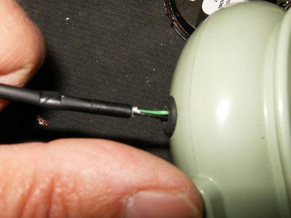

    • Here is the damage of the speaker standoff

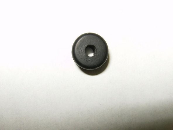

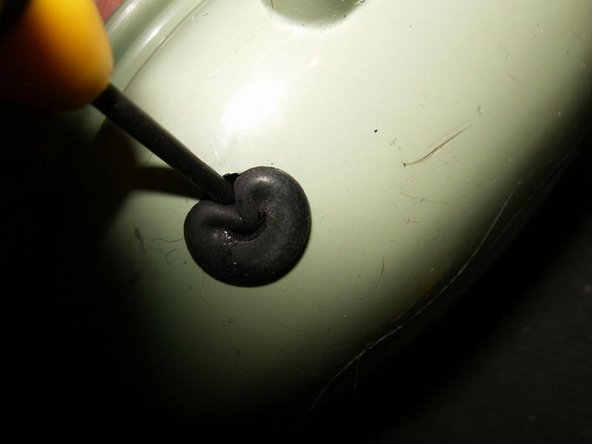

    • Remove the rubber grommet from the speaker cable opening by using a jewelers screw driver. Gently use the screw driver to push the lip out of the opening.
    • Removed rubber grommet.
