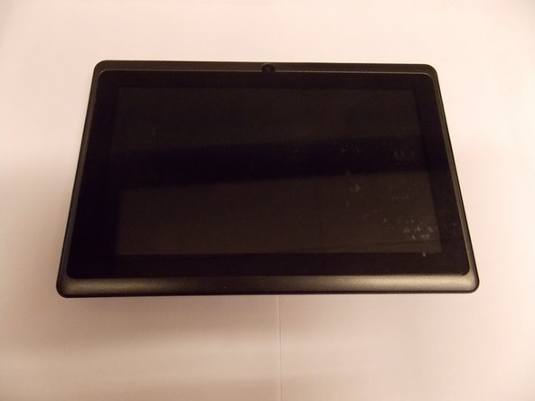

    • Be sure to repair your device on a clean surface so you are less likely to lose small parts.
  2. Datawind Ubislate 7ci Speaker Replacement, Pry open your tablet: crwdns2935265:02crwdnd2935265:01crwdnd2935265:02crwdne2935265:0 Datawind Ubislate 7ci Speaker Replacement, Pry open your tablet: crwdns2935265:02crwdnd2935265:02crwdnd2935265:02crwdne2935265:0
    • Run your prying tool along the front edge of the device to pop off the front cover.
    • Once the halves are separated, your device should look like this.
    • (HINT: be careful of the device's small wiring when separating the two halves)
  3. Datawind Ubislate 7ci Speaker Replacement, Removing the speaker: crwdns2935265:03crwdnd2935265:01crwdnd2935265:01crwdne2935265:0
    • Use your prying tool to pop the speaker out from its housing.
  4. Datawind Ubislate 7ci Speaker Replacement, Detach from contact points: crwdns2935265:04crwdnd2935265:01crwdnd2935265:01crwdne2935265:0
    • Use a soldering iron to remove the speaker from its contact points.
  5. Datawind Ubislate 7ci Speaker Replacement, Attaching replacement to contact points: crwdns2935265:05crwdnd2935265:01crwdnd2935265:01crwdne2935265:0
    • Solder your new speaker to the same contact points as before.
  6. Datawind Ubislate 7ci Speaker Replacement, Housing the replacement speaker: crwdns2935265:06crwdnd2935265:01crwdnd2935265:01crwdne2935265:0
    • Apply a small amount of adhesive to the new speaker, and place it into the housing on the back panel.
  7. Datawind Ubislate 7ci Speaker Replacement, Putting your tablet back together: crwdns2935265:07crwdnd2935265:01crwdnd2935265:02crwdne2935265:0 Datawind Ubislate 7ci Speaker Replacement, Putting your tablet back together: crwdns2935265:07crwdnd2935265:02crwdnd2935265:02crwdne2935265:0
    • Put the two halves back together.
    • Push down on the edges until you hear them click into place.
