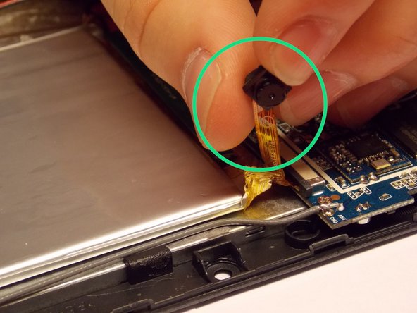

  3. Datawind Ubislate 7ci Rear Facing Camera Replacement, Removing the tape around the camera: crwdns2935265:03crwdnd2935265:01crwdnd2935265:02crwdne2935265:0 Datawind Ubislate 7ci Rear Facing Camera Replacement, Removing the tape around the camera: crwdns2935265:03crwdnd2935265:02crwdnd2935265:02crwdne2935265:0
    • Remove the black tape that is circled.
    • The camera is circled in this picture.

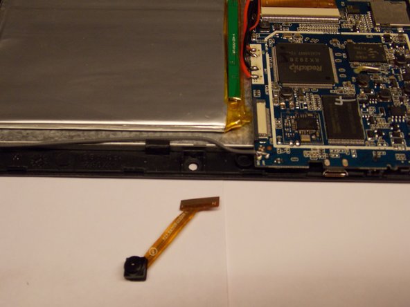

  4. Datawind Ubislate 7ci Rear Facing Camera Replacement, Removing the camera: crwdns2935265:04crwdnd2935265:01crwdnd2935265:02crwdne2935265:0 Datawind Ubislate 7ci Rear Facing Camera Replacement, Removing the camera: crwdns2935265:04crwdnd2935265:02crwdnd2935265:02crwdne2935265:0
    • Carefully remove the camera from its housing.

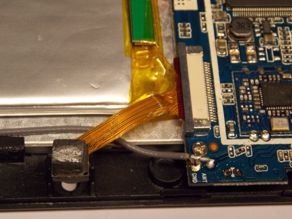

  5. Datawind Ubislate 7ci Rear Facing Camera Replacement, Inserting the Replacement Camera: crwdns2935265:05crwdnd2935265:01crwdnd2935265:02crwdne2935265:0 Datawind Ubislate 7ci Rear Facing Camera Replacement, Inserting the Replacement Camera: crwdns2935265:05crwdnd2935265:02crwdnd2935265:02crwdne2935265:0
    • Slide the new camera into its housing carefully.
    • it should look like the second picture when you are finished
