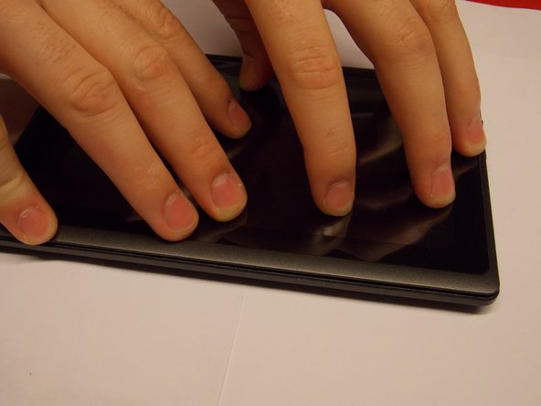

    • Run your prying tool along the front edge of the device to pop off the front cover.
    • Once the halves are separated your device should look like this.
    • Be careful of the device's small wiring when separating the two halves.

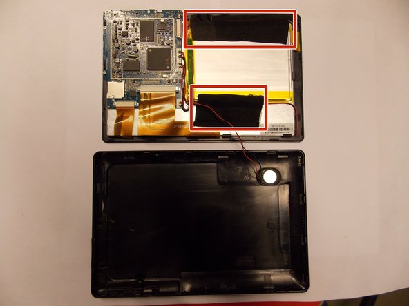

  2. Datawind Ubislate 7ci Battery Replacement: crwdns2935265:02crwdnd2935265:01crwdnd2935265:03crwdne2935265:0 Datawind Ubislate 7ci Battery Replacement: crwdns2935265:02crwdnd2935265:02crwdnd2935265:03crwdne2935265:0 Datawind Ubislate 7ci Battery Replacement: crwdns2935265:02crwdnd2935265:03crwdnd2935265:03crwdne2935265:0
    • Remove the black tape.
    • Be careful not to remove the tablet camera.

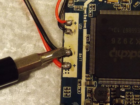

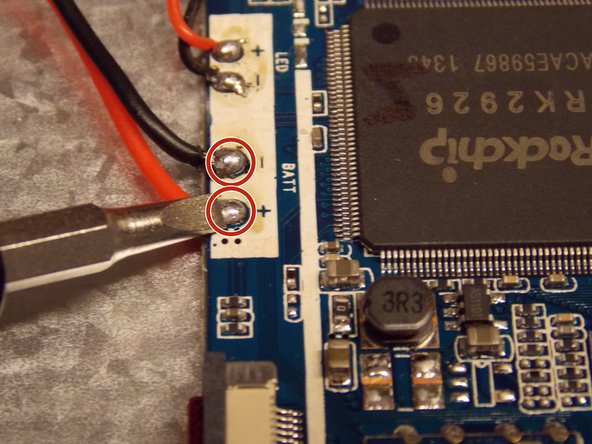

  3. Datawind Ubislate 7ci Battery Replacement: crwdns2935265:03crwdnd2935265:01crwdnd2935265:03crwdne2935265:0 Datawind Ubislate 7ci Battery Replacement: crwdns2935265:03crwdnd2935265:02crwdnd2935265:03crwdne2935265:0 Datawind Ubislate 7ci Battery Replacement: crwdns2935265:03crwdnd2935265:03crwdnd2935265:03crwdne2935265:0
    • Use a soldering iron to remove the battery from both its attachment points.
    • Pry off the battery using an opening tool.

    • Solder the new battery to the connection points.
