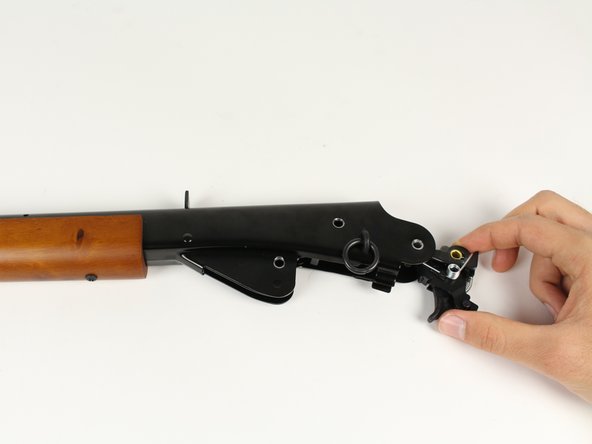

  6. Daisy Model 10 Carbine Firing Mechanism Spring Replacement, Remove the Firing Mechanism: crwdns2935265:06crwdnd2935265:01crwdnd2935265:03crwdne2935265:0 Daisy Model 10 Carbine Firing Mechanism Spring Replacement, Remove the Firing Mechanism: crwdns2935265:06crwdnd2935265:02crwdnd2935265:03crwdne2935265:0 Daisy Model 10 Carbine Firing Mechanism Spring Replacement, Remove the Firing Mechanism: crwdns2935265:06crwdnd2935265:03crwdnd2935265:03crwdne2935265:0
    • Wiggling the firing mechanism and pull it out of the back opening of the carbine.
    • There is oil on the firing mechanism and it may be slippery.
    • The firing mechanism may take some maneuvering and time to get out of the gun.

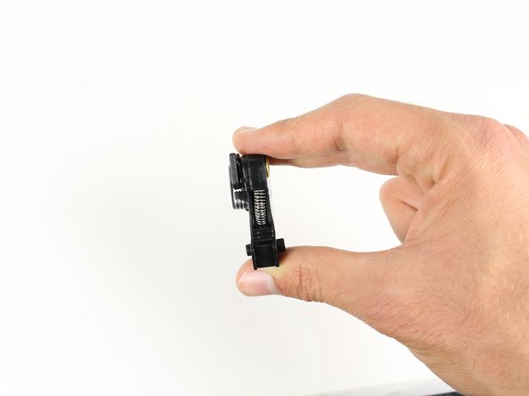

  7. Daisy Model 10 Carbine Firing Mechanism Spring Replacement, Removing the Damaged Spring: crwdns2935265:07crwdnd2935265:01crwdnd2935265:02crwdne2935265:0 Daisy Model 10 Carbine Firing Mechanism Spring Replacement, Removing the Damaged Spring: crwdns2935265:07crwdnd2935265:02crwdnd2935265:02crwdne2935265:0
    • Hold the firing mechanism so that the trigger is pointed away from you.
    • Locate the damaged spring attached to the firing mechanism.
    • Locate your tweezers and place one tong near the top of the spring.
    • Place the other tong of the tweezers towards the bottom of the spring.
    • Push your tweezers into the spring about a centimeter, allowing the tweezers to penetrate the spring slightly.
    • Push the tweezers together, compressing the spring, until the spring is free from the firing mechanism.
    • The spring can potentially fly out if not removed carefully!
    • The spring is small and can easily be lost.
