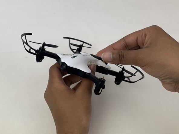

      • Make sure the drone is powered off before beginning the battery replacement.
      • To turn the drone off, press and hold the black button on the top of the drone until all lights are off.
      • Firmly grasp the battery tab between your thumb and index finger.
      • Pull the battery away from the drone's body
    1. DROCON Ninja Propeller Replacement, Propeller: crwdns2935265:02crwdnd2935265:01crwdnd2935265:02crwdne2935265:0 DROCON Ninja Propeller Replacement, Propeller: crwdns2935265:02crwdnd2935265:02crwdnd2935265:02crwdne2935265:0
      • Firmly grasp the blade guard from the bottom of the drone
      • Pull the blade guard straight down away from motor.
    2. DROCON Ninja Propeller Replacement: crwdns2935265:03crwdnd2935265:01crwdnd2935265:03crwdne2935265:0 DROCON Ninja Propeller Replacement: crwdns2935265:03crwdnd2935265:02crwdnd2935265:03crwdne2935265:0 DROCON Ninja Propeller Replacement: crwdns2935265:03crwdnd2935265:03crwdnd2935265:03crwdne2935265:0
      • Take note of the letter printed on the bottom of the propeller. Make sure the replacement propeller has the same letter.
      • Grasp the center of the propeller that needs to be replaced.
      • Pull the propeller directly up and away from the motor.
