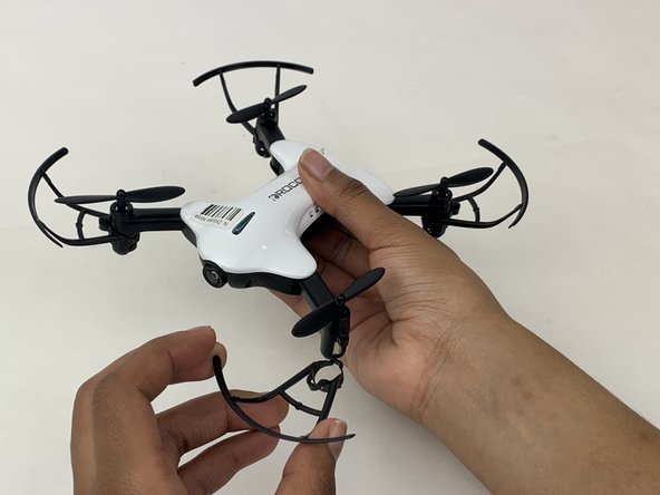

      • Firmly grasp the blade guard from the bottom of the drone
      • Pull the blade guard straight down away from motor.

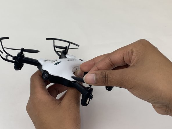

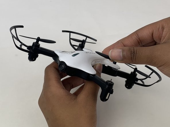

      • Grasp the center of the propeller that needs to be replaced.
      • Pull the propeller directly up and away from the motor.

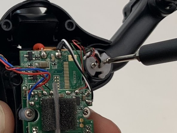

    3. DROCON Ninja Motor Replacement: crwdns2935265:07crwdnd2935265:01crwdnd2935265:03crwdne2935265:0 DROCON Ninja Motor Replacement: crwdns2935265:07crwdnd2935265:02crwdnd2935265:03crwdne2935265:0 DROCON Ninja Motor Replacement: crwdns2935265:07crwdnd2935265:03crwdnd2935265:03crwdne2935265:0

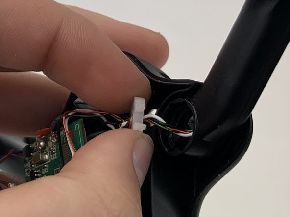

      • Use a Phillips #00 screwdriver to remove the two 5mm screws connecting the motor arm to the drone's body.
      • Use your fingers to gently pull the white plastic disc out of the motor arm.
    4. DROCON Ninja Motor Replacement: crwdns2935265:08crwdnd2935265:01crwdnd2935265:03crwdne2935265:0 DROCON Ninja Motor Replacement: crwdns2935265:08crwdnd2935265:02crwdnd2935265:03crwdne2935265:0 DROCON Ninja Motor Replacement: crwdns2935265:08crwdnd2935265:03crwdnd2935265:03crwdne2935265:0
      • Grasp the motor arm and pull up and away from the drone's body.
    5. DROCON Ninja Motor Replacement: crwdns2935265:09crwdnd2935265:01crwdnd2935265:03crwdne2935265:0 DROCON Ninja Motor Replacement: crwdns2935265:09crwdnd2935265:02crwdnd2935265:03crwdne2935265:0 DROCON Ninja Motor Replacement: crwdns2935265:09crwdnd2935265:03crwdnd2935265:03crwdne2935265:0

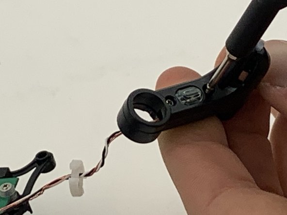

      • Use a Phillips #00 screwdriver to remove the three 4mm screws on the plate of the motor arm.
      • Using your fingers, pull apart the top and bottom pieces of the casing.
    6. DROCON Ninja Motor Replacement: crwdns2935265:010crwdnd2935265:01crwdnd2935265:03crwdne2935265:0 DROCON Ninja Motor Replacement: crwdns2935265:010crwdnd2935265:02crwdnd2935265:03crwdne2935265:0 DROCON Ninja Motor Replacement: crwdns2935265:010crwdnd2935265:03crwdnd2935265:03crwdne2935265:0
      • Use the opening tool to remove the small circuit board from the motor arm.

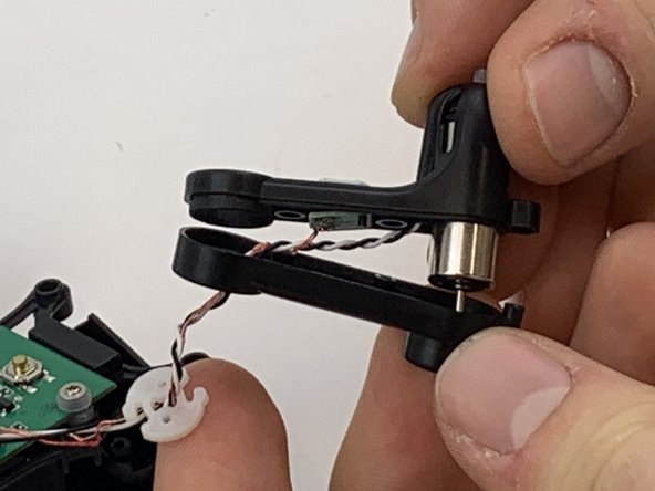

    7. DROCON Ninja Motor Replacement: crwdns2935265:011crwdnd2935265:01crwdnd2935265:03crwdne2935265:0 DROCON Ninja Motor Replacement: crwdns2935265:011crwdnd2935265:02crwdnd2935265:03crwdne2935265:0 DROCON Ninja Motor Replacement: crwdns2935265:011crwdnd2935265:03crwdnd2935265:03crwdne2935265:0
      • Use a pair of pliers to remove the motor by pulling up and away from the propeller arm.
