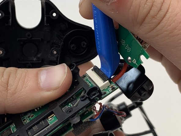

    3. DROCON Ninja Camera Replacement: crwdns2935265:04crwdnd2935265:01crwdnd2935265:03crwdne2935265:0 DROCON Ninja Camera Replacement: crwdns2935265:04crwdnd2935265:02crwdnd2935265:03crwdne2935265:0 DROCON Ninja Camera Replacement: crwdns2935265:04crwdnd2935265:03crwdnd2935265:03crwdne2935265:0
      • Insert the opening tool under one of the black plastic connector slots that connects the circuit-board to the casing.
      • Gently pull the opening tool toward you to disconnect the circuit-board from the plastic casing.

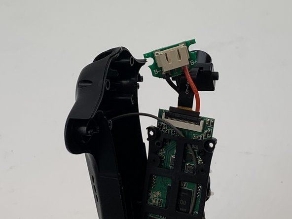

    1. DROCON Ninja Camera Replacement, Camera: crwdns2935265:05crwdnd2935265:01crwdnd2935265:03crwdne2935265:0 DROCON Ninja Camera Replacement, Camera: crwdns2935265:05crwdnd2935265:02crwdnd2935265:03crwdne2935265:0 DROCON Ninja Camera Replacement, Camera: crwdns2935265:05crwdnd2935265:03crwdnd2935265:03crwdne2935265:0

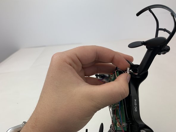

      • Use a Phillips #00 screwdriver to remove the 5mm screws connecting the front two motor arms to the drone's body.
      • Use your fingers to gently pull the white plastic discs out of the motor arms.

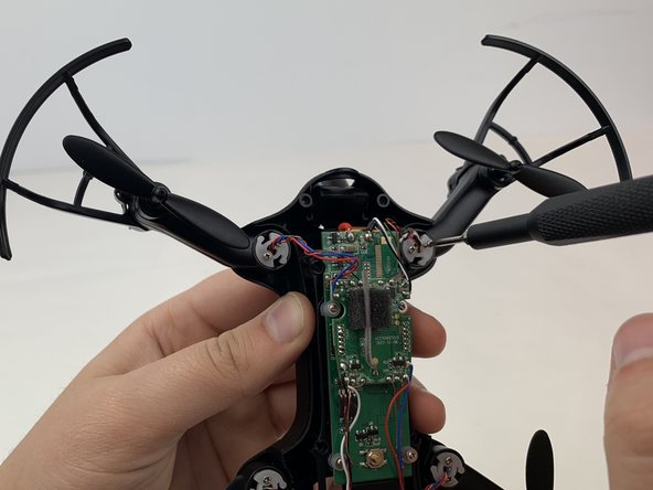

    2. DROCON Ninja Camera Replacement: crwdns2935265:06crwdnd2935265:01crwdnd2935265:02crwdne2935265:0 DROCON Ninja Camera Replacement: crwdns2935265:06crwdnd2935265:02crwdnd2935265:02crwdne2935265:0
      • Grasp the motor arm and pull up and away from the drone's body.
      • Repeat this step for the other front motor arm.

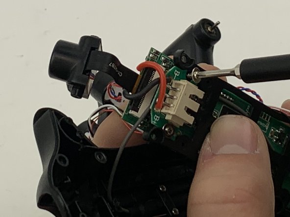

    3. DROCON Ninja Camera Replacement: crwdns2935265:07crwdnd2935265:01crwdnd2935265:03crwdne2935265:0 DROCON Ninja Camera Replacement: crwdns2935265:07crwdnd2935265:02crwdnd2935265:03crwdne2935265:0 DROCON Ninja Camera Replacement: crwdns2935265:07crwdnd2935265:03crwdnd2935265:03crwdne2935265:0
      • Using the Phillips #00 screwdriver, remove the two 3mm screws on the control board.

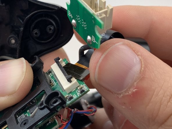

    4. DROCON Ninja Camera Replacement: crwdns2935265:08crwdnd2935265:01crwdnd2935265:03crwdne2935265:0 DROCON Ninja Camera Replacement: crwdns2935265:08crwdnd2935265:02crwdnd2935265:03crwdne2935265:0 DROCON Ninja Camera Replacement: crwdns2935265:08crwdnd2935265:03crwdnd2935265:03crwdne2935265:0
      • Using the opening tool flip up the black plastic clamp that holds the camera wire to the circuit board.
      • Gently pull the camera out from the control board.
