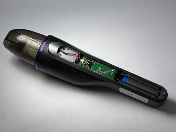

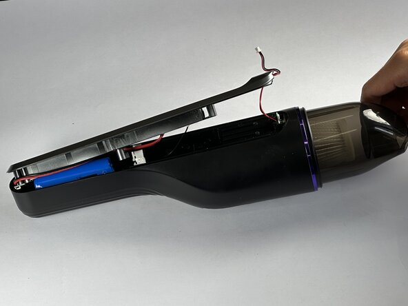

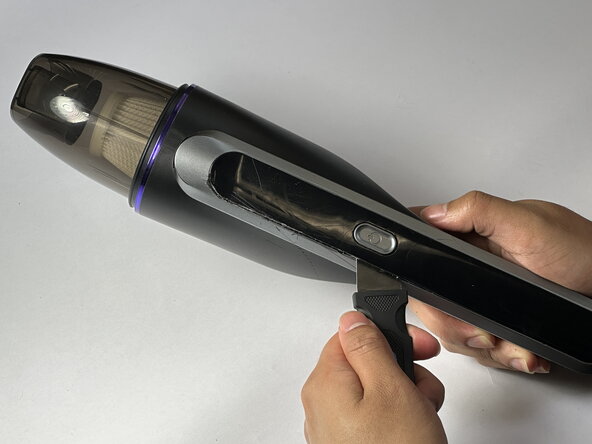

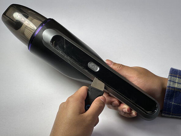

    • Use a Jimmy to pry open the panel to access the battery.

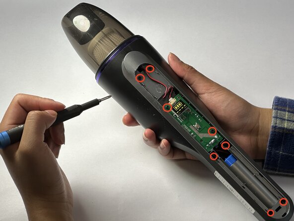

    • Using a Phillips #00 screwdriver, remove the eight screws from the vacuum.

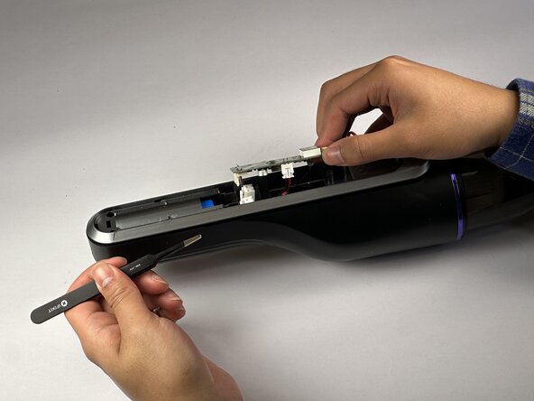

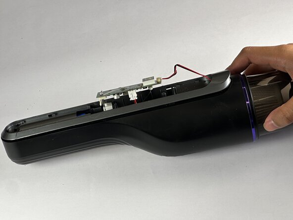

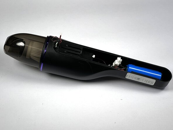

    • Remove the motherboard simultaneously with the wire connecting to motor and the battery.
  4. DRECELL VC021 Battery Replacement: crwdns2935265:04crwdnd2935265:01crwdnd2935265:03crwdne2935265:0 DRECELL VC021 Battery Replacement: crwdns2935265:04crwdnd2935265:02crwdnd2935265:03crwdne2935265:0 DRECELL VC021 Battery Replacement: crwdns2935265:04crwdnd2935265:03crwdnd2935265:03crwdne2935265:0

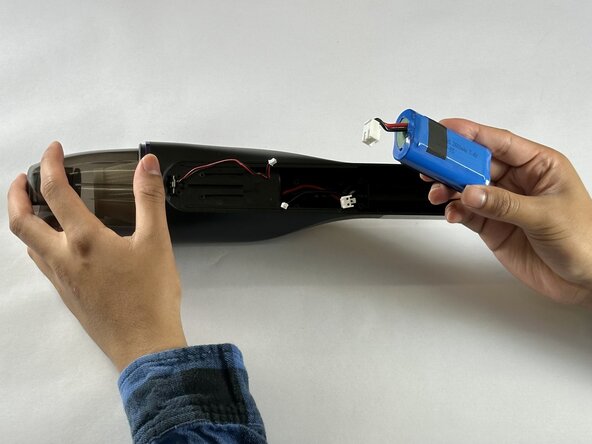

    • Carefully remove the battery from the vacuum shell.
