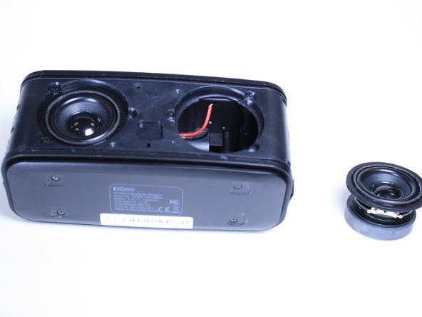

  2. DOSS SoundBox Motherboard Replacement, Speaker: crwdns2935265:02crwdnd2935265:01crwdnd2935265:02crwdne2935265:0 DOSS SoundBox Motherboard Replacement, Speaker: crwdns2935265:02crwdnd2935265:02crwdnd2935265:02crwdne2935265:0
    • Use the JIS #00 screwdriver to remove the 3/32" screws that secure the speaker to the body.
    • Remove the smaller 3/32" screws that secure the left side of the speaker with a JIS #1 screwdriver.
    • The smaller screws are still the same length, but they have smaller screw heads. You can use the same screwdriver for both.
    • Using a Magnetic Mat throughout this process will help prevent losing screws.

  4. DOSS SoundBox Motherboard Replacement: crwdns2935265:04crwdnd2935265:01crwdnd2935265:02crwdne2935265:0 DOSS SoundBox Motherboard Replacement: crwdns2935265:04crwdnd2935265:02crwdnd2935265:02crwdne2935265:0
    • Use a soldering iron to de-solder the two speaker wires from the speaker itself.
    • The speakers are ready to be removed and replaced.
    • Ensure that the device is turned off when handling bare wire.
    • Soldering iron is very hot.

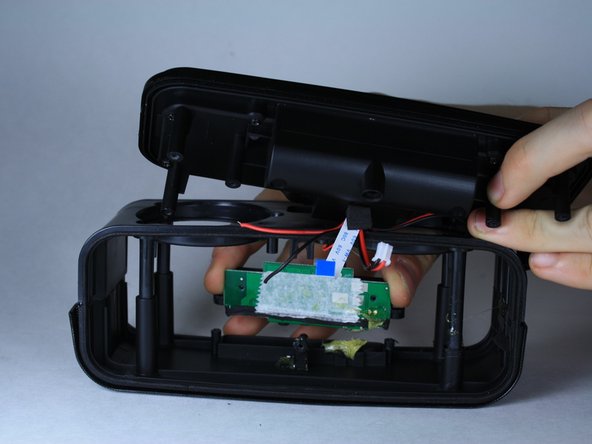

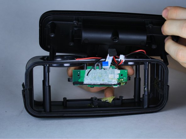

  7. DOSS SoundBox Motherboard Replacement: crwdns2935265:07crwdnd2935265:01crwdnd2935265:01crwdne2935265:0
    • Remove the six 3/32" screws marked with red circles using a JIS #00 screwdriver.
    • Remove the larger 3/32" screw indicated by an orange circle using a JIS #1 screwdriver.
    • Once the screws are removed, gently lift the top (where the touch controls are) off of the speaker.

  9. DOSS SoundBox Motherboard Replacement, Motherboard: crwdns2935265:09crwdnd2935265:01crwdnd2935265:01crwdne2935265:0
    • Follow the steps leading up to the actual battery removal, but do not actually remove the battery.
    • Remove the two 3/32" screws that attach the motherboard to the battery compartment using a JIS #00 screwdriver.
    • Use your fingers or a pair of tweezers to remove the clip holding the ribbon connector in place. The connector is indicated with an orange marker.
    • Be sure not to apply excessive force on the ribbon connector, as it can break.
    • Find the speaker connector, indicated by a yellow circle, and using your fingers disconnect it.
  10. DOSS SoundBox Motherboard Replacement: crwdns2935265:010crwdnd2935265:01crwdnd2935265:02crwdne2935265:0 DOSS SoundBox Motherboard Replacement: crwdns2935265:010crwdnd2935265:02crwdnd2935265:02crwdne2935265:0
    • Locate and remove the two 3/32" screws, indicated by red markers, that fix the motherboard to the speaker enclosure.
  11. DOSS SoundBox Motherboard Replacement: crwdns2935265:011crwdnd2935265:01crwdnd2935265:03crwdne2935265:0 DOSS SoundBox Motherboard Replacement: crwdns2935265:011crwdnd2935265:02crwdnd2935265:03crwdne2935265:0 DOSS SoundBox Motherboard Replacement: crwdns2935265:011crwdnd2935265:03crwdnd2935265:03crwdne2935265:0
    • Using the plastic opening tool, gently begin to pry the circuit card away from the speaker enclosure.
    • There is adhesive on the top of the motherboard, use caution while prying to avoid breakage.
    • Using your fingers, you can now remove the motherboard.
