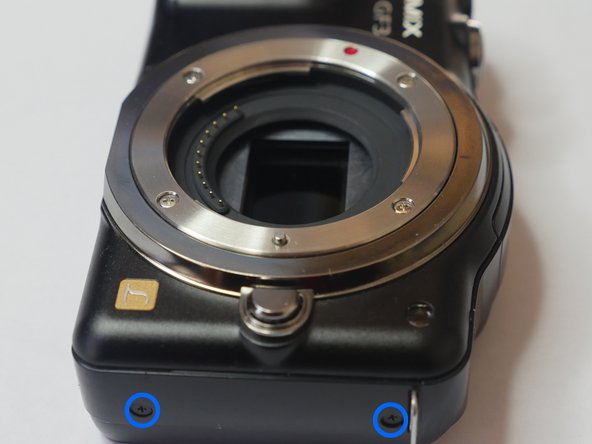

  2. DMC-GF3 LCD Display Replacement: crwdns2935265:02crwdnd2935265:01crwdnd2935265:02crwdne2935265:0 DMC-GF3 LCD Display Replacement: crwdns2935265:02crwdnd2935265:02crwdnd2935265:02crwdne2935265:0
    • Remove 4 (2mm) screws from the bottom of the unit.

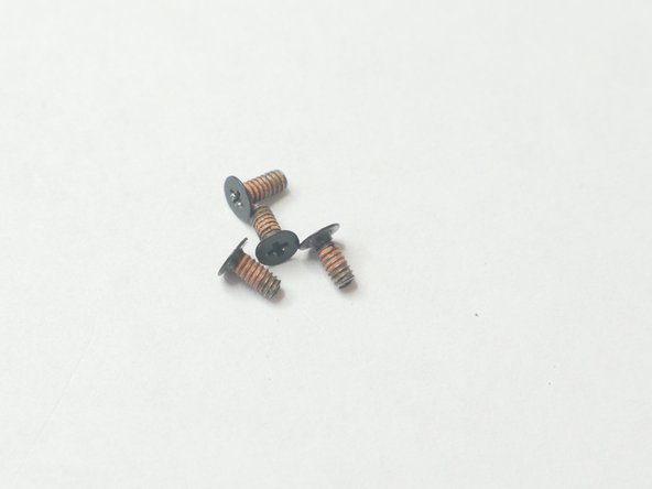

    • Remove 4 (4mm) screws from the sides of the unit. You are removing screws from both the right and left sides of the unit (4 screws total)

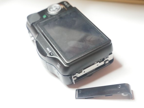

  4. DMC-GF3 LCD Display Replacement: crwdns2935265:04crwdnd2935265:01crwdnd2935265:02crwdne2935265:0 DMC-GF3 LCD Display Replacement: crwdns2935265:04crwdnd2935265:02crwdnd2935265:02crwdne2935265:0
    • Slightly lift up the left side of unit to remove the side panel. Do not remove the rear chassis. Just lift up enough to remove side panel.
    • Caution. The rear Chassis is attached to two ribbon panels so please do not remove the chassis in this step.

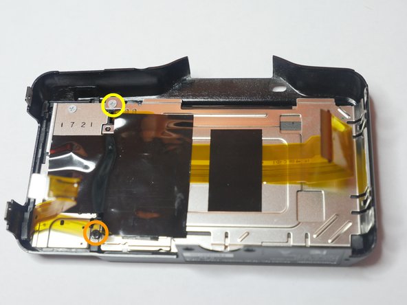

  6. DMC-GF3 LCD Display Replacement: crwdns2935265:06crwdnd2935265:01crwdnd2935265:01crwdne2935265:0
    • Remove flex cable using a spudger or other method. Remove rear casing.
    • These plastic clamps are fragile and break easily. Use caution when releasing the cable. Use equal pressure throughout entire clamp or risk breaking the clamp.
