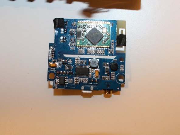

In this guide we will show you a step-by-step replacement guide for the Motherboard. You want to be careful when unplugging the speakers and battery from the board itself in order to not damage any of the wires.
The motherboard contains the following components:
Power Switch
Bluetooth sensor
Auxiliary port
Charging Port

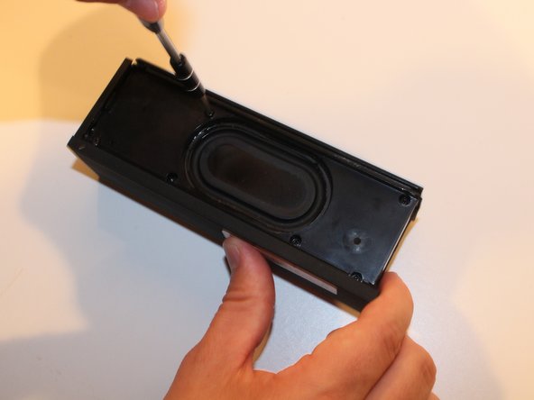

    3. DKnight MagicBox II Motherboard  Replacement: crwdns2935265:03crwdnd2935265:01crwdnd2935265:02crwdne2935265:0 DKnight MagicBox II Motherboard  Replacement: crwdns2935265:03crwdnd2935265:02crwdnd2935265:02crwdne2935265:0
      • On the back panel (Opposite to the side containing the two speakers), Use the Philips head PH1 to remove all 7 screws (Screws: Head PH1 , Length 7cm).
    4. DKnight MagicBox II Motherboard  Replacement: crwdns2935265:04crwdnd2935265:01crwdnd2935265:02crwdne2935265:0 DKnight MagicBox II Motherboard  Replacement: crwdns2935265:04crwdnd2935265:02crwdnd2935265:02crwdne2935265:0
      • Pull apart the two faces to separate the back panel from the front face plate.

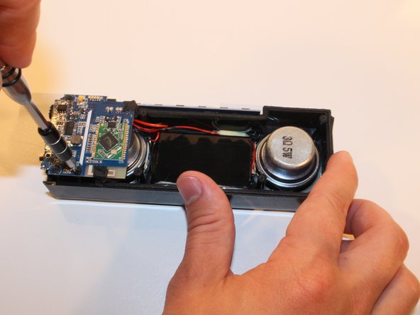

    1. DKnight MagicBox II Motherboard  Replacement, Motherboard: crwdns2935265:05crwdnd2935265:01crwdnd2935265:02crwdne2935265:0 DKnight MagicBox II Motherboard  Replacement, Motherboard: crwdns2935265:05crwdnd2935265:02crwdnd2935265:02crwdne2935265:0
      • Remove the single screw holding the motherboard to the front panel (Screw : Head PH1, Size .5 cm)
    2. DKnight MagicBox II Motherboard  Replacement: crwdns2935265:06crwdnd2935265:01crwdnd2935265:01crwdne2935265:0
      • Using your fingers gently pry the motherboard loose from the black insulant adhesive
    3. DKnight MagicBox II Motherboard  Replacement: crwdns2935265:07crwdnd2935265:01crwdnd2935265:01crwdne2935265:0
      • Disconnect the Button Panel plug (Largest of the Plugs, it can be traced back to the button panel easily)
    4. DKnight MagicBox II Motherboard  Replacement: crwdns2935265:08crwdnd2935265:01crwdnd2935265:01crwdne2935265:0
      • Use the tweezers to push down on the safety prongs on the plastic switch. Then Disconnect the Power Wire plug by hand (Red medium),
    5. DKnight MagicBox II Motherboard  Replacement: crwdns2935265:09crwdnd2935265:01crwdnd2935265:01crwdne2935265:0
      • Use the tweezers to push down on the two safety prongs on the plastic switch. Then Disconnect the two Speaker plug connections by hand (Two Smaller Plugs)
    6. DKnight MagicBox II Motherboard  Replacement: crwdns2935265:010crwdnd2935265:01crwdnd2935265:02crwdne2935265:0 DKnight MagicBox II Motherboard  Replacement: crwdns2935265:010crwdnd2935265:02crwdnd2935265:02crwdne2935265:0
      • The Motherboard is now free from the speaker assembly
