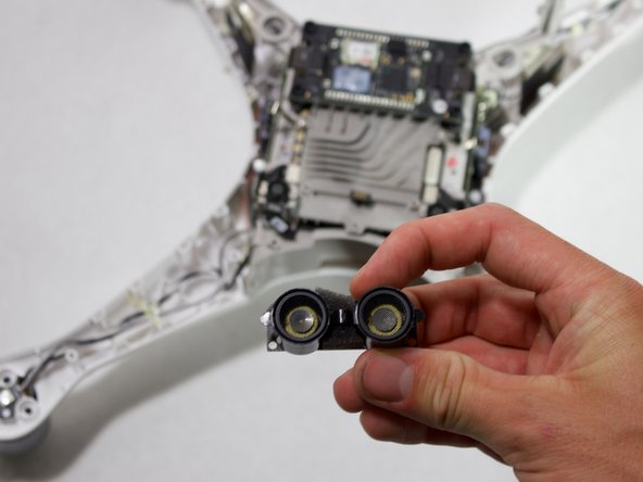

  12. DJI Phantom 4 Advanced Ultrasonic Sensor Replacement, Ultrasonic Sensor: crwdns2935265:012crwdnd2935265:01crwdnd2935265:02crwdne2935265:0 DJI Phantom 4 Advanced Ultrasonic Sensor Replacement, Ultrasonic Sensor: crwdns2935265:012crwdnd2935265:02crwdnd2935265:02crwdne2935265:0
    • Remove the three 2.8 mm screws with a JIS #000 screwdriver.
    • The screw on the back of the ultrasonic sensor is covered by foam.
  13. DJI Phantom 4 Advanced Ultrasonic Sensor Replacement: crwdns2935265:013crwdnd2935265:01crwdnd2935265:02crwdne2935265:0 DJI Phantom 4 Advanced Ultrasonic Sensor Replacement: crwdns2935265:013crwdnd2935265:02crwdnd2935265:02crwdne2935265:0
    • Pry the ribbon cable off the ultrasonic sensor using a plastic opening tool.
