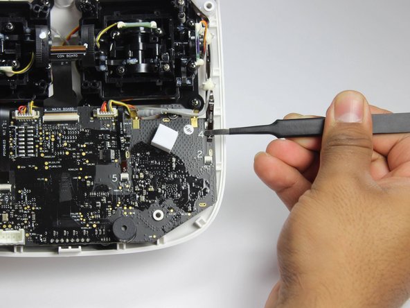

  6. DJI Phantom 4 Advanced Remote Controller Power Button Replacement, Motherboard: crwdns2935265:06crwdnd2935265:01crwdnd2935265:03crwdne2935265:0 DJI Phantom 4 Advanced Remote Controller Power Button Replacement, Motherboard: crwdns2935265:06crwdnd2935265:02crwdnd2935265:03crwdne2935265:0 DJI Phantom 4 Advanced Remote Controller Power Button Replacement, Motherboard: crwdns2935265:06crwdnd2935265:03crwdnd2935265:03crwdne2935265:0
    • Disconnect ribbon tabs 1,2,5,8G, and 3.
    • Remove ribbon tab by pulling gently along motherboard. Do not pull straight out.
    • Then remove the plugs

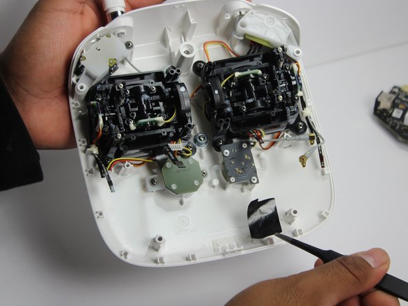

  9. DJI Phantom 4 Advanced Remote Controller Power Button Replacement, Power Button: crwdns2935265:09crwdnd2935265:01crwdnd2935265:02crwdne2935265:0 DJI Phantom 4 Advanced Remote Controller Power Button Replacement, Power Button: crwdns2935265:09crwdnd2935265:02crwdnd2935265:02crwdne2935265:0
    • Carefully remove the plastic. This will help you gain access to the power button panel.

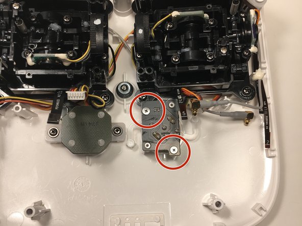

  10. DJI Phantom 4 Advanced Remote Controller Power Button Replacement: crwdns2935265:010crwdnd2935265:01crwdnd2935265:02crwdne2935265:0 DJI Phantom 4 Advanced Remote Controller Power Button Replacement: crwdns2935265:010crwdnd2935265:02crwdnd2935265:02crwdne2935265:0
    • With a Phillips #00 screwdriver, remove the two screws on the power button panel.
