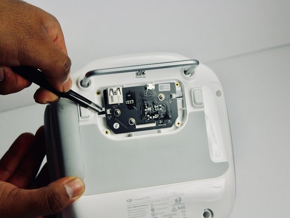

    • With tweezers, gently remove the large con board tab.
    • Use your hands to remove the two small clips. Pull out from the socket, in a horizontal direction.
