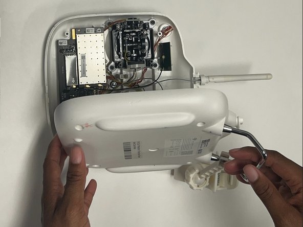

    • Position the controller so the back is facing up and the joysticks are resting on the table.
    • Remove the four 11 mm screws that secure the back plate using a JIS #0 screwdriver.
    • Remove the back plate, being mindful of the wires still connected to the device.
  2. DJI Phantom 3 Standard Remote Controller USB Charge Port Replacement: crwdns2935265:02crwdnd2935265:01crwdnd2935265:01crwdne2935265:0
    • Unplug the wire from the motherboard.
  3. DJI Phantom 3 Standard Remote Controller USB Charge Port Replacement: crwdns2935265:03crwdnd2935265:01crwdnd2935265:01crwdne2935265:0
    • Remove the two 7 mm screws using a JIS #000 screwdriver.
  4. DJI Phantom 3 Standard Remote Controller USB Charge Port Replacement: crwdns2935265:04crwdnd2935265:01crwdnd2935265:01crwdne2935265:0
    • Remove the wire and USB port.
